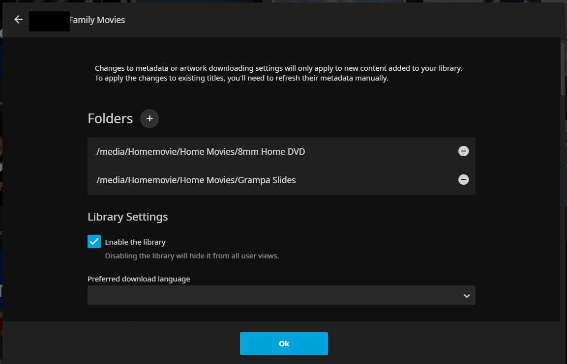

    added to that library another path
    media/home movies/Home Movies/grampa slides/ (3 video files here)

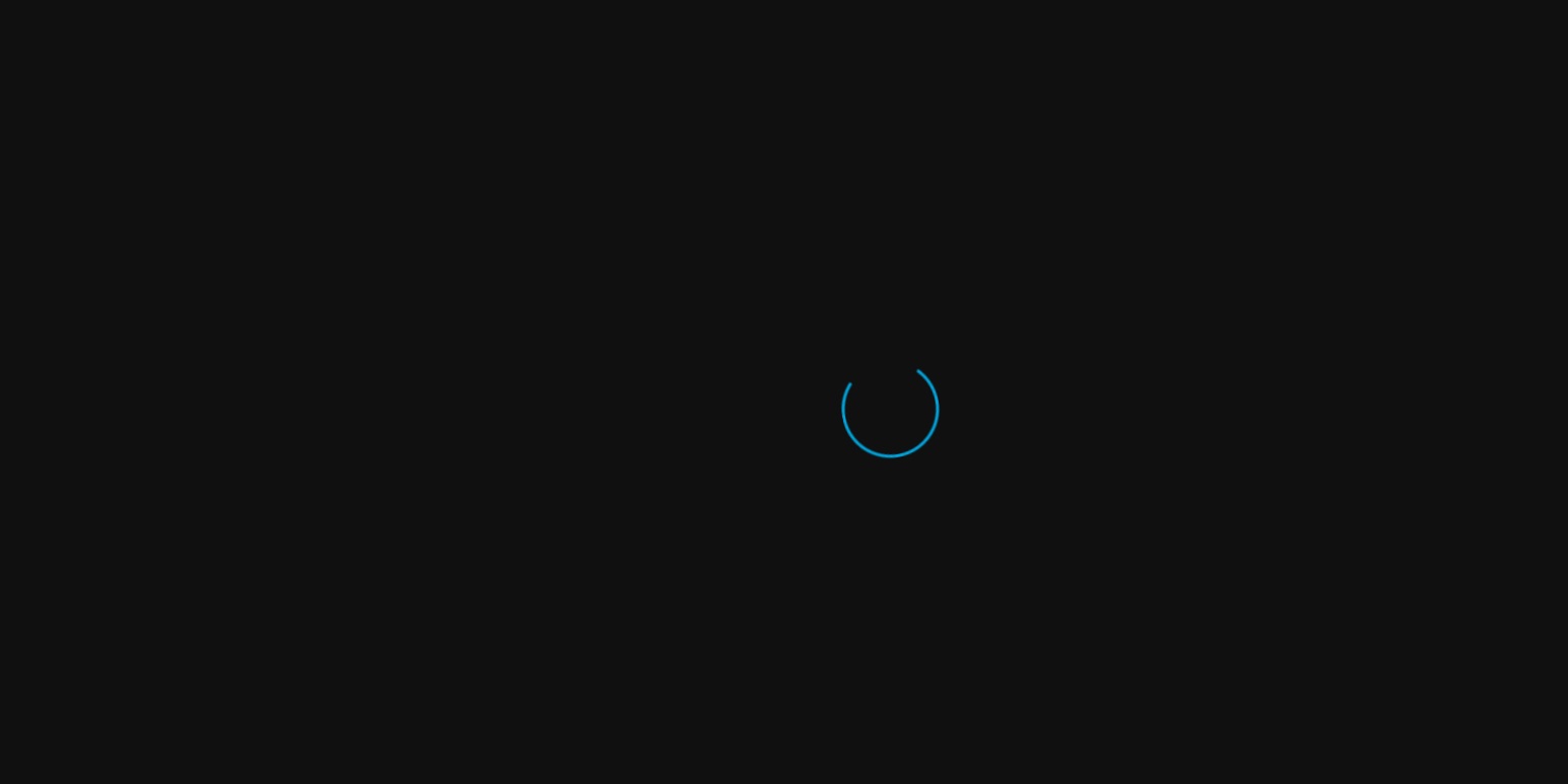

    Made user that can only see this library
    When trying to access library can see
    home movies icon > click > 8mm Home DVD > when click to display movies nothing shows and get spinning wheel
    movies from Grampa slides shows and plays.
    The reason for this is because I have other family movies in media/Homemovies/Home Movies/ that I need to not show in this library but use in a different library.
    If I check the box for "enable access to all libraries" then all shows show up in that library and work.

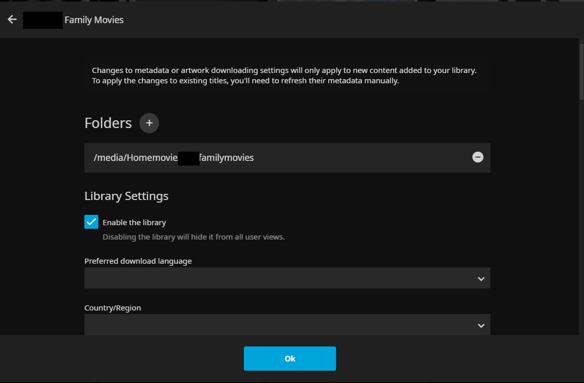

    My work around is copying those files to its own folder with media/home movies/familymovies/8mm Home DVD/season 01/home dvd movies S01E01.m4v
    and setting the library to path media/home movies/familymovies
    This is 2 folders with same file.
    Wondering if there is a way to have just 1 main folder and why it works if i select the enable access to all libraries.

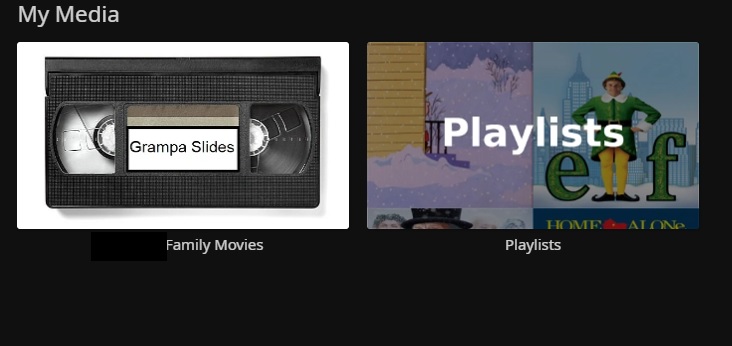

    to add first thumbnail is the work around. 2nd one i have is how i have the library paths when it doesn't work unless allow all libraries is selected.
    3rd is it working when all libraries are selected.

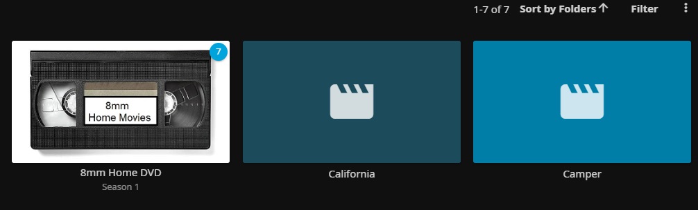

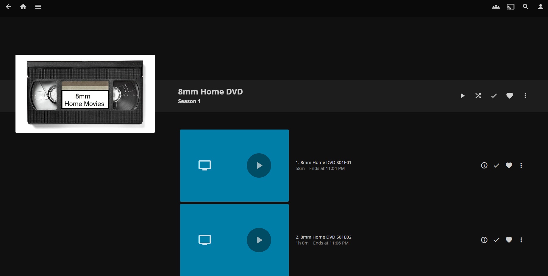

    4 and 5 are going to library when not working
    6 is what i get after selecting 8mm on 5th thumb nail. 2 videos camper and California if clicked on will work.

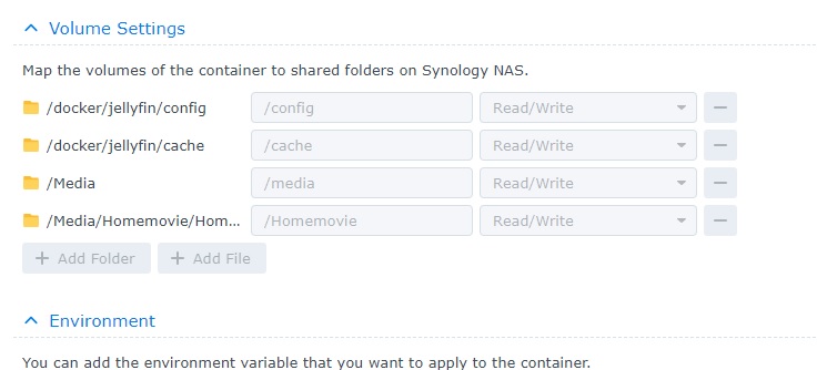

    Pointing docker to media/Homemovie/Home Movies and putting as /Homemovie

    The best solution I found was pointing container to the Home Movies folder bypassing the homemovie folder and naming it accordingly. If not I found I would have to make a copy of the video files that takes double the space.
    I just hope it doesn't break though.
    attached is the file format of container. before only had /media but added in the homemovie. Things are working now but I didn't know if it was suppose to work the other way and something was wrong.
