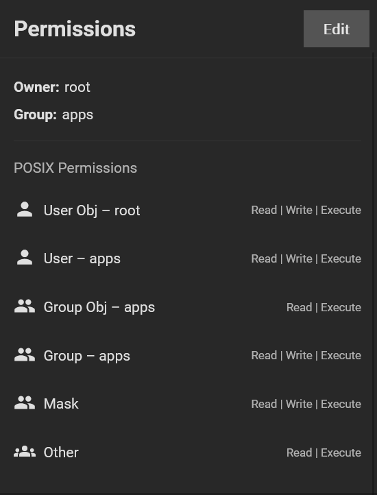

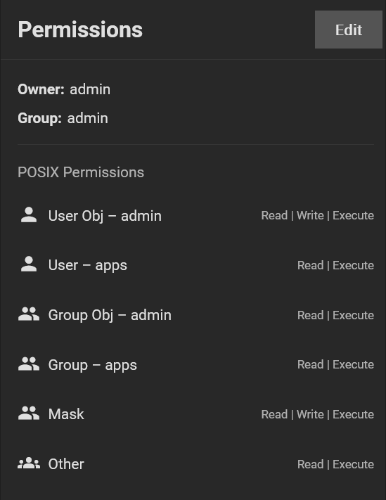

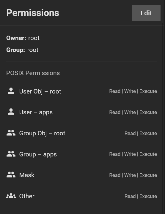

    (2024-07-20, 10:22 AM)eminemfan Wrote: Hey, can I what ACL's did you set for the new config host path? I've tried with setting the user and group to apps but no luck. Based on the errors in the log and the fact that almost every every poster from metadata is not loading I'm pretty sure the migrated files are unreadable to the new jellyfin
    So I have my main dataset which has read exec for everyone then I have the jellyfin dataset with those permissions:
    Then, the config dataset with those ones:
    Cache:
    Also, in the app setup, I didn't check the box to enable ACL for the storage, might be the something to look into.
