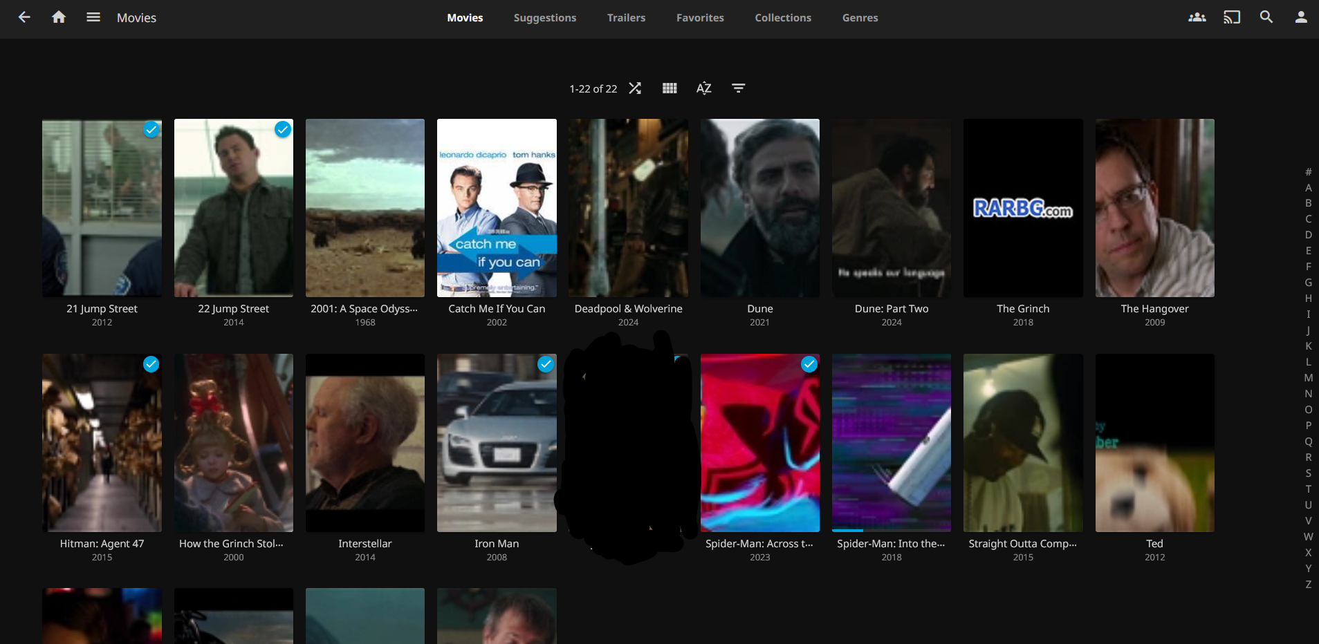

    Hello. I just went in and changed al my movies to follow this file naming scheme, movie_name (year).mp4 (i made sure I had the right file extension. After I did this none of my movies show any posters anymore? Any help would be greatly appreciated.

    Can you share your logs via privatebin.net? I'm betting your server isn't able to connect to the Internet.
    Can you also describe your setup? Host OS? Installation method?

    Hello, I couldn't get paste bin to work to share my logs, I was able to get a git hub gist to work however so here is that. https://gist.github.com/urltanoob/535187...ab80c6779b
    I'm running it on a pi5 running pi os headless with casa os. I just used the install from the integrated app store. I have it running tail scale and I have port 8096 forwarded so I can access it all devices.

    Yeah. Jellyfin can't reach the Internet with the current setup.
    jellyfin  | [17:23:37] [ERR] [25] MediaBrowser.Providers.Movies.MovieMetadataService: Error in TheMovieDb
    jellyfin  | System.Net.Http.HttpRequestException: Resource temporarily unavailable (api.themoviedb.org:443)
    You'd need to setup split tunneling so that Jellyfin can still reach the Internet.
