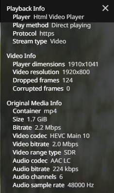

    I made the switch to Jellyfin about six months ago from emby and have run into an issue with dropped frames on random movies using the Roku app.  Some movies will play fine and others stutter so badly due to dropped frames that the movie is unwatchable. After doing some more digging when playing through Chrome or Vivaldi web browser (chrome based) on my PC or phone I have the same issue with dropped frames.  When playing through the Firefox I do not experience dropped frames.  In each instance the movie is direct playing and the movies that drop frames do so on my Roku's and Chrome based browsers.  So far the only fix I've found is to remux the movies using MKVToolNix which solves the issue.

    Firefox does not play HEVC, period, AFAIK so it may have been transcoding. Your solution of remuxing tells me that the file was probably borked (not uncommon). Remuxing regenerates "packet time stamps" and various other non-video/audio components of the container that coordinate video/audio timing, which is often the cause of otherwise unexplained stuttering or dropped frames.

    (2024-07-04, 04:50 PM)TheDreadPirate Wrote: Firefox does not play HEVC, period, AFAIK so it may have been transcoding.  Your solution of remuxing tells me that the file was probably borked (not uncommon).  Remuxing regenerates "packet time stamps" and various other non-video/audio components of the container that coordinate video/audio timing, which is often the cause of otherwise unexplained stuttering or dropped frames.
    Thank you for your feedback and I was afraid you would say this.  It's why I held off posting for a few months to play with things on my own.... I will either remux all my rips or take the time to test them individually.
