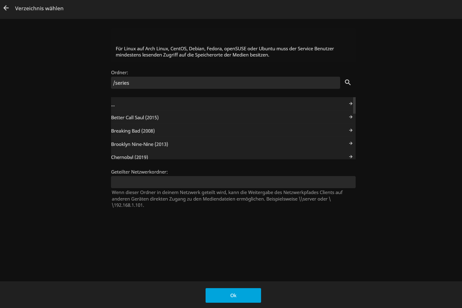

    In the Jellyfin Web UI, the series folder is correctly detected with all seasons and extras.

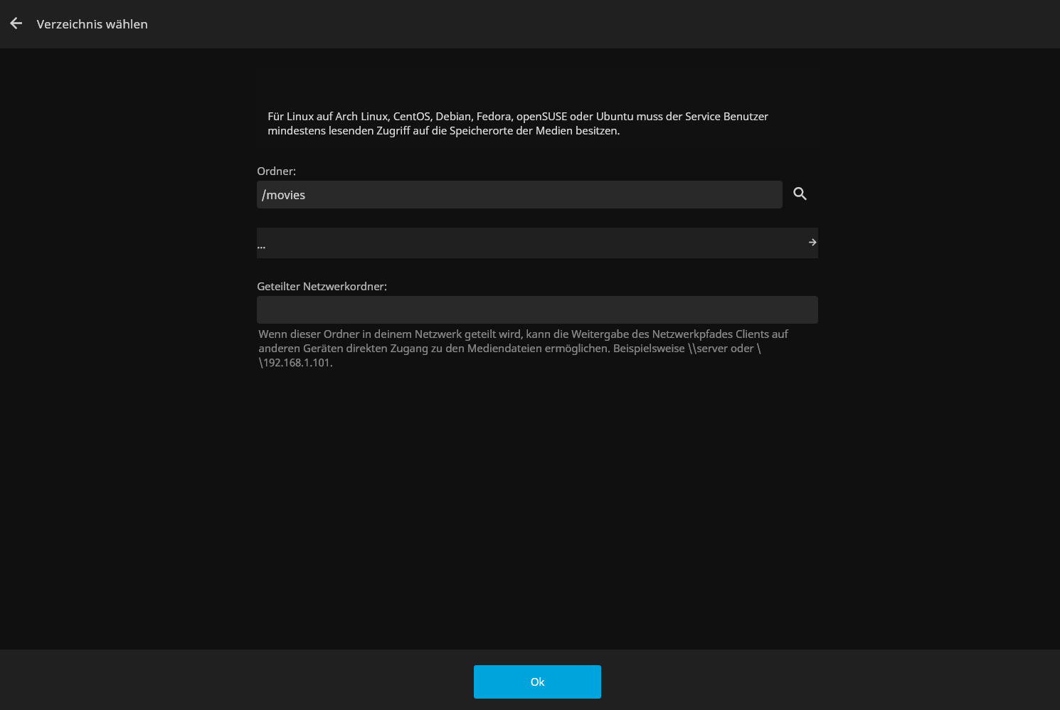

    The movie folder is shown, but no movies or folders are detected.
    In the menu where you can choose the directory, I can go into all the subfolders of the series folder but the movies folder doesn't show any subfolders.
    The movies are then also not detected.
