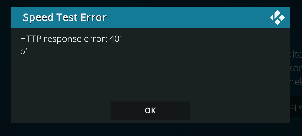

    After it i was asked to input my credentials and Jellycon asked me if it should be doing a connection speed test. I clicked yes and that test also failed. Adding my music library is still not possible.

    This same thread is fine. I don't recall seeing that particular error in the past and I can't replicate it right now on any of my systems. First guess would be have you restarted Kodi since getting logged in? It shouldn't be necessary, but if you had failed connection attempts already maybe something funny got cached. If that doesn't work we may need to delete the user auth file entirely and give it a fresh start.

    I tried both: First connection speed test was done automatically by Jellycon addon after the right connection data was added.
    Then i restarted Kodi and repeated the process in the Jellycon addon to see if connection speed test was working after restart. The result was the same in both cases (like shown in the screenshot).
    Ok, checking cache first or deleting user auth file right away?

    Restarting Kodi should have cleared the cache. So we'll try deleting the app's data and start fresh. Assuming Windows, it should be at "C:\Users\<YourUsername>\AppData\Roaming\Kodi\userdata\addon_data\plugin.video.jellycon". If not Windows, you can find the relevant path here: https://kodi.wiki/view/Kodi_data_folder. At a minimum you should delete the 'auth.json' file, however if you wanna be real thorough you can delete the entire jellycon folder there.

    If there's no auth.json file, that would certainly explain why you're getting unauthorized when trying to make api requests, but I can't imagine how it could've gotten into this state. tmsrxzar is correct, you'll want to delete userdata/addon_data/plugin.video.jellycon. Probably best to have kodi turned off when you do so, and the next time you start it the install wizard should start again.

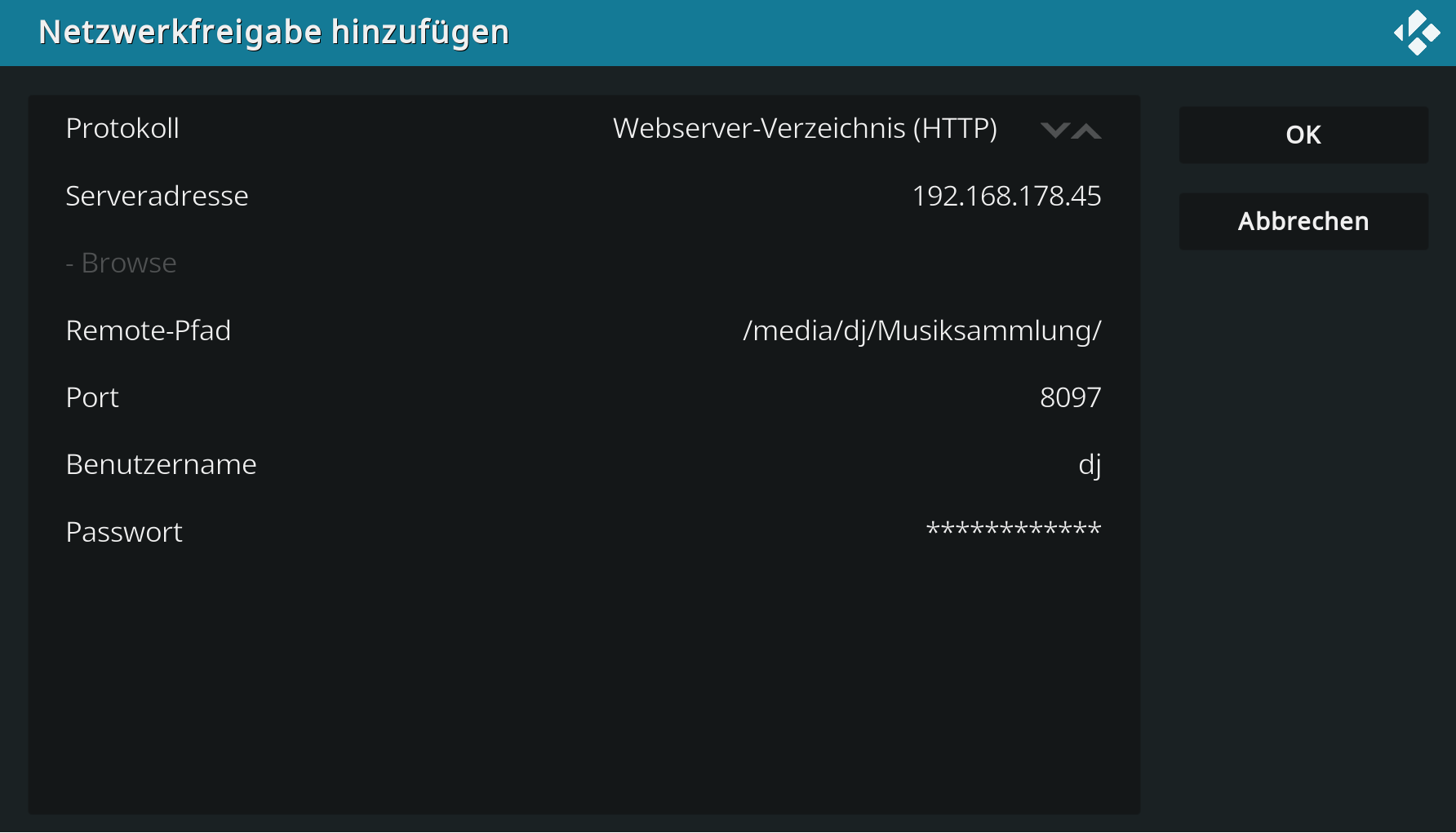

    Deleting the userdata/jellycon folder helped at least enough to complete the connection speed test. Auth.json is now in the userdata/jellycon folder. Now i try to add my music folder (see picture) but Kodi says it cannot find it.
