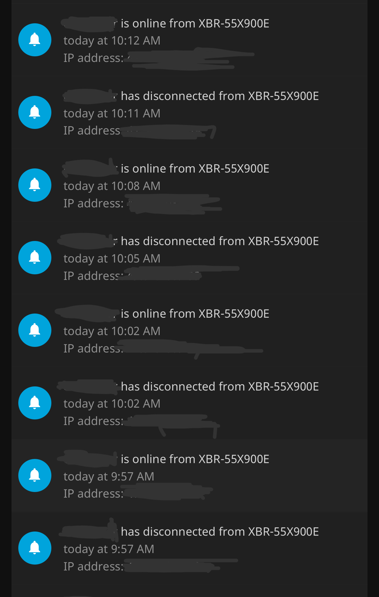

    I have a remote user that can connect to my server without issue.  But once they're connected and they leave the app, their status shows that they're online then disconnected within a minute and just keep repeating this.  It's the only user that's doing it and the Sony TV Andoroid App is the only device that's doing it also.  Their other devices can connect without issue.
    Any thoughts would be greatly appreciated.

    This is probably Android TV polling Jellyfin for new content for the Android TV home screen. IIRC, Android TV does this check every 5 mins, which lines up with your activity log.

    (2023-10-18, 02:41 PM)TheDreadPirate Wrote: This is probably Android TV polling Jellyfin for new content for the Android TV home screen.  IIRC, Android TV does this check every 5 mins, which lines up with your activity log.
    Yeah that absolutely seems to be the issue.  I'm going to test it out on my Nvidia Shield here and I'll try to walk the remote user through some of the other suggestions in the other thread.

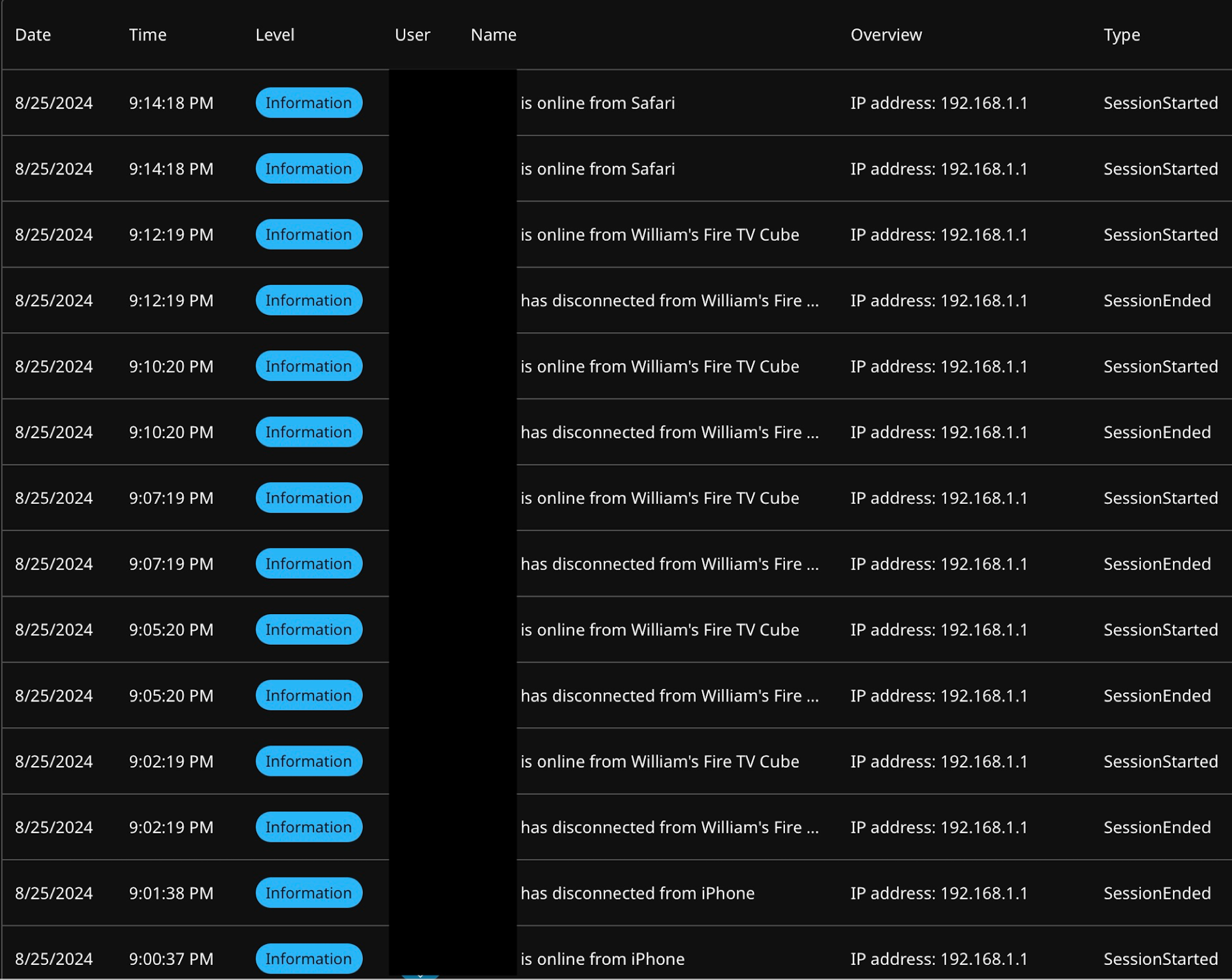

    I'm also having the same issue. This is for myself locally on a Firestick. No performance issues whatsoever, just non stop logging. Definitely interested in the solution as well

    I'm also having this issue. The logs show my android tv and my phone are constantly connecting/disconnecting. Which makes it impossible to see any relevant activity. I would love to disable or delete this "polling", but the activity is written to the database which makes it tricky to delete.
