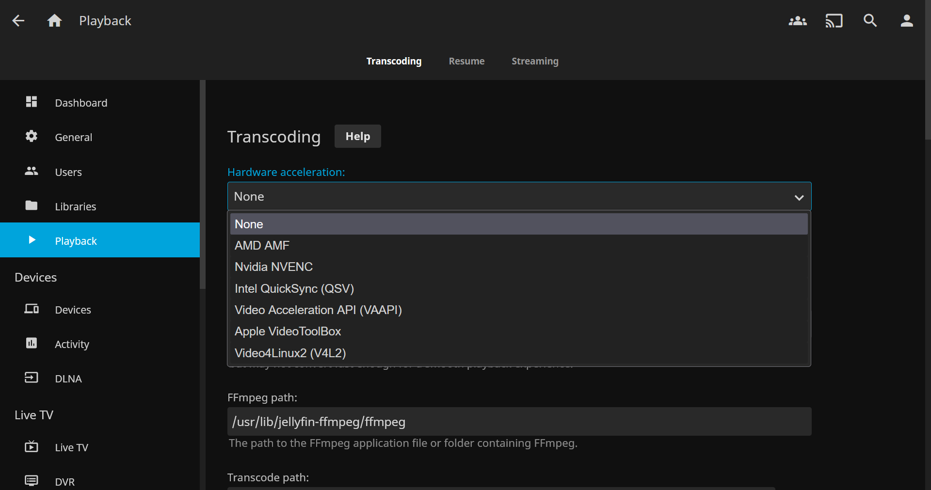

    It also is worth noting that within the Jellyfin logs, I do see the following line:
    jellyfin | [11:23:57] [INF] [1] MediaBrowser.MediaEncoding.Encoder.MediaEncoder: Available hwaccel types: ["drm", "opencl", "rkmpp"]
    Even though that line was always present, there never has been an RKMPP option in the hardware acceleration dropdown.

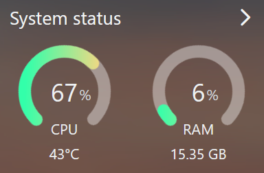

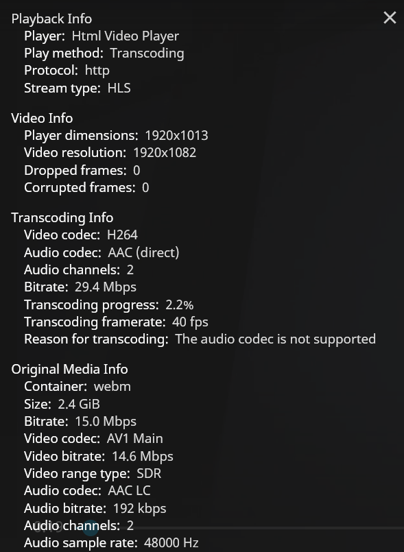

    Added a couple more images showing the 30-40fps transcoding which I suspect to be software transcoding along with the unusually high CPU usage during playback. CPU usage was spiking up to around 80% at the highest I saw.

    Bad news is that even though there is an RKMPP option in the hardware transcoding menu now, it doesn't seem to work. It keeps falling back to software decoding, as evident by the ~30fps transcoding framerate and ~80% CPU usage. I'll update the post with the new logs.
