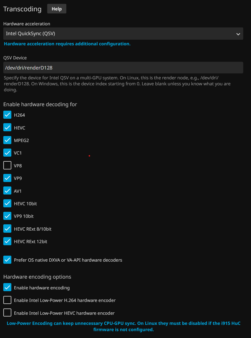

    I have a new mini home server, one of those amazon mini firewall computers. I bought it barebone with an Intel N100 and put 16GB RAM and a 1TB SSD (Kingston NV3) into it. I run Proxmox on it and Jellyfin as an priviliged container on it that I set up according to the documentation. The container has 16GB storage, 4GB RAM, access to all 4 cores, the GPU is passed through. After setting up the container I installed Jellyfin using the generic linux auto repository method and set everything up within Jellyfin. Transcoding works great in terms of hardware utilisation, it 4K causes little CPU usage, RAM usage stays low. I also set up transcoding following strictly the documentation.

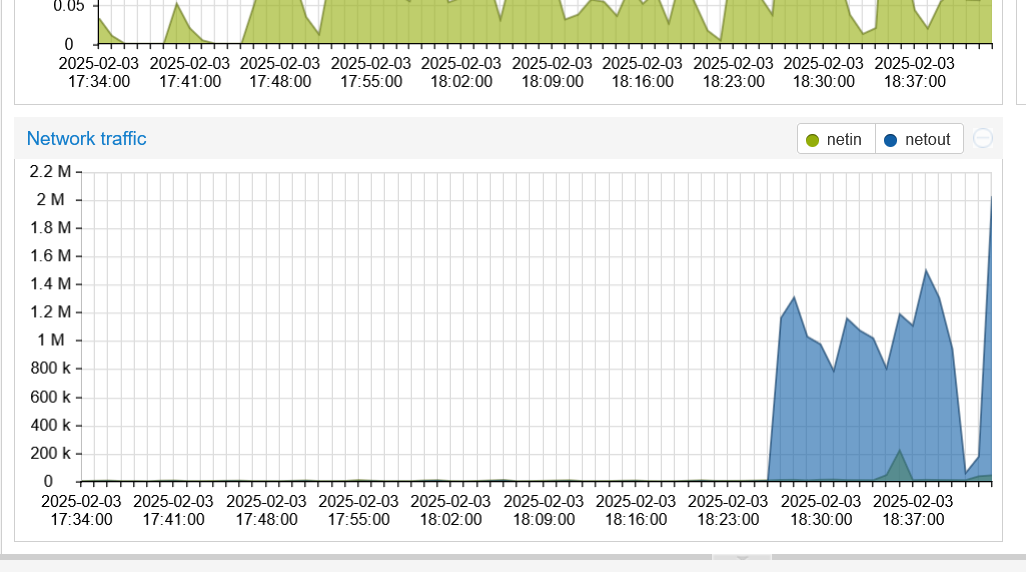

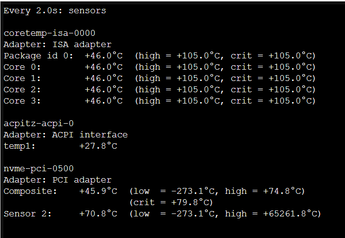

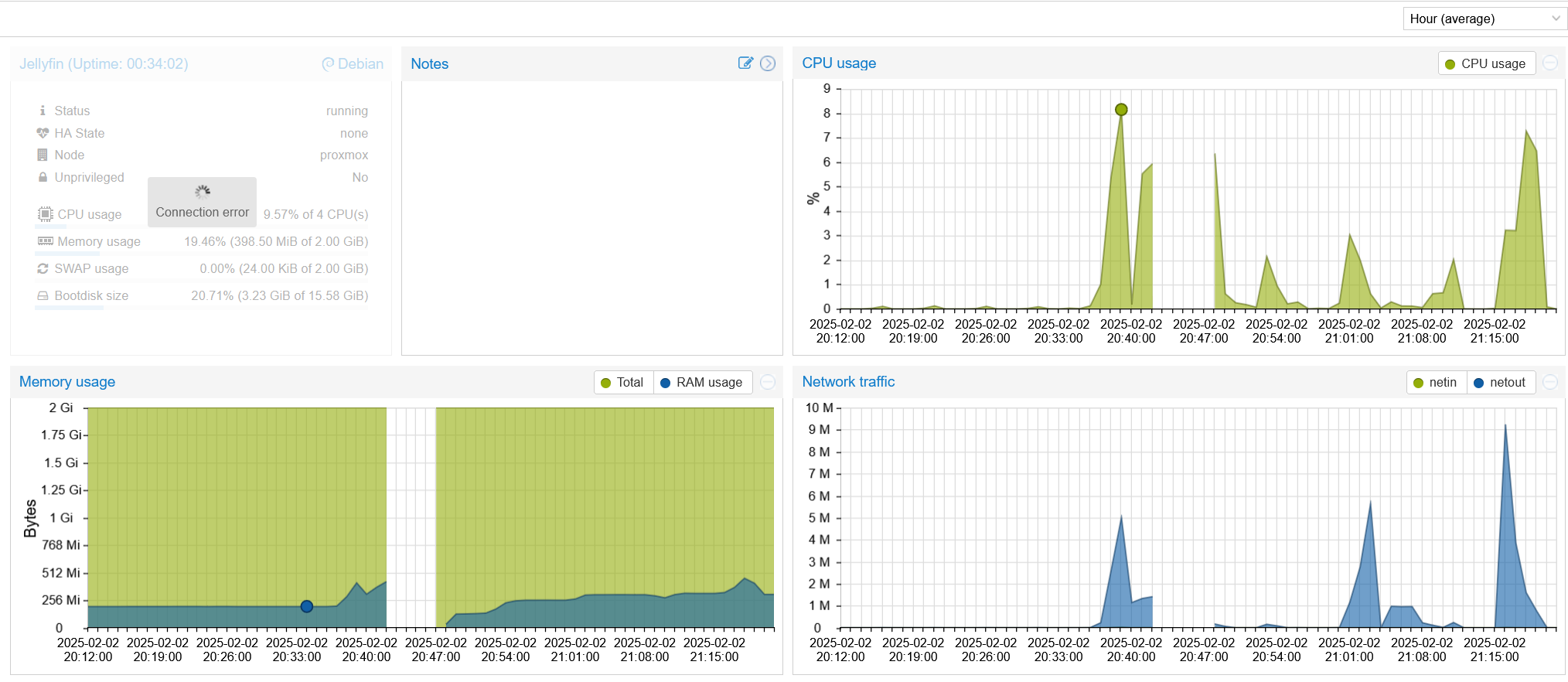

    So I also checked Proxmox: The container summary shows no problem with CPU, RAM, storage (see screenshots that I made when a crash occured). There is also no temp problem. All temps stay below 50°C (ssd, cpu).

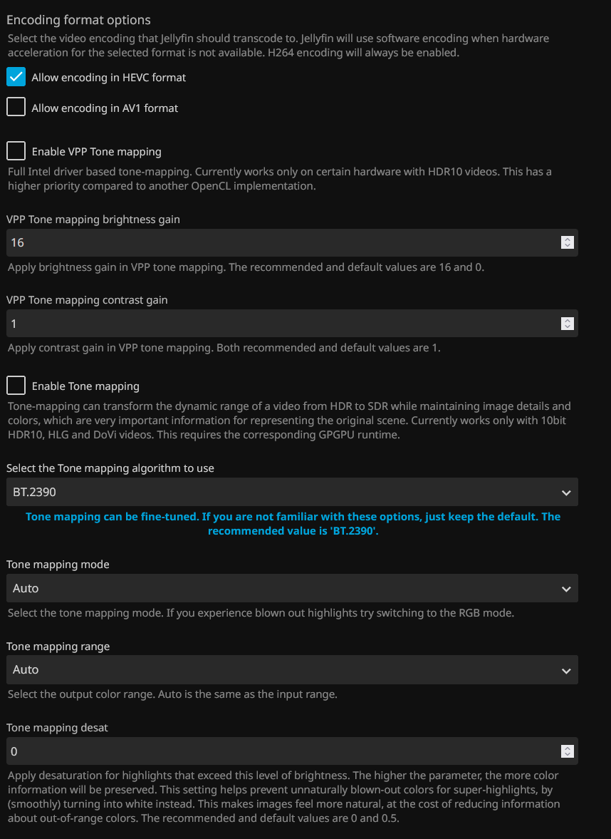

    See attached also my transcoding config as well as a part of the debug log when the crash occured.
