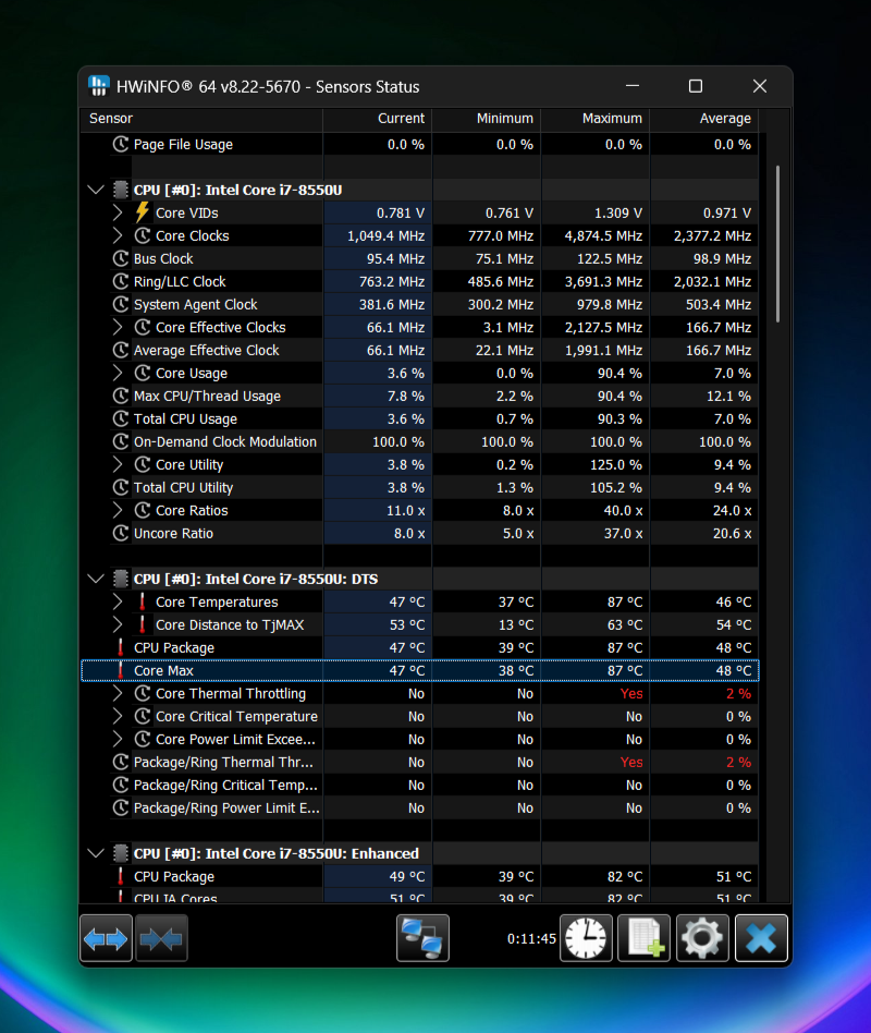

    2025-03-25, 07:55 PM
    I guess keep HWInfo64 open on the laptop and monitor temps and whatnot to try and see what is going on. Maybe this is a thermal issue and you need to repaste this old laptop.

    2025-03-25, 08:51 PM
    So I found a couple of things in red and not 100 percent sure it means I need to replace the paste or where to go
