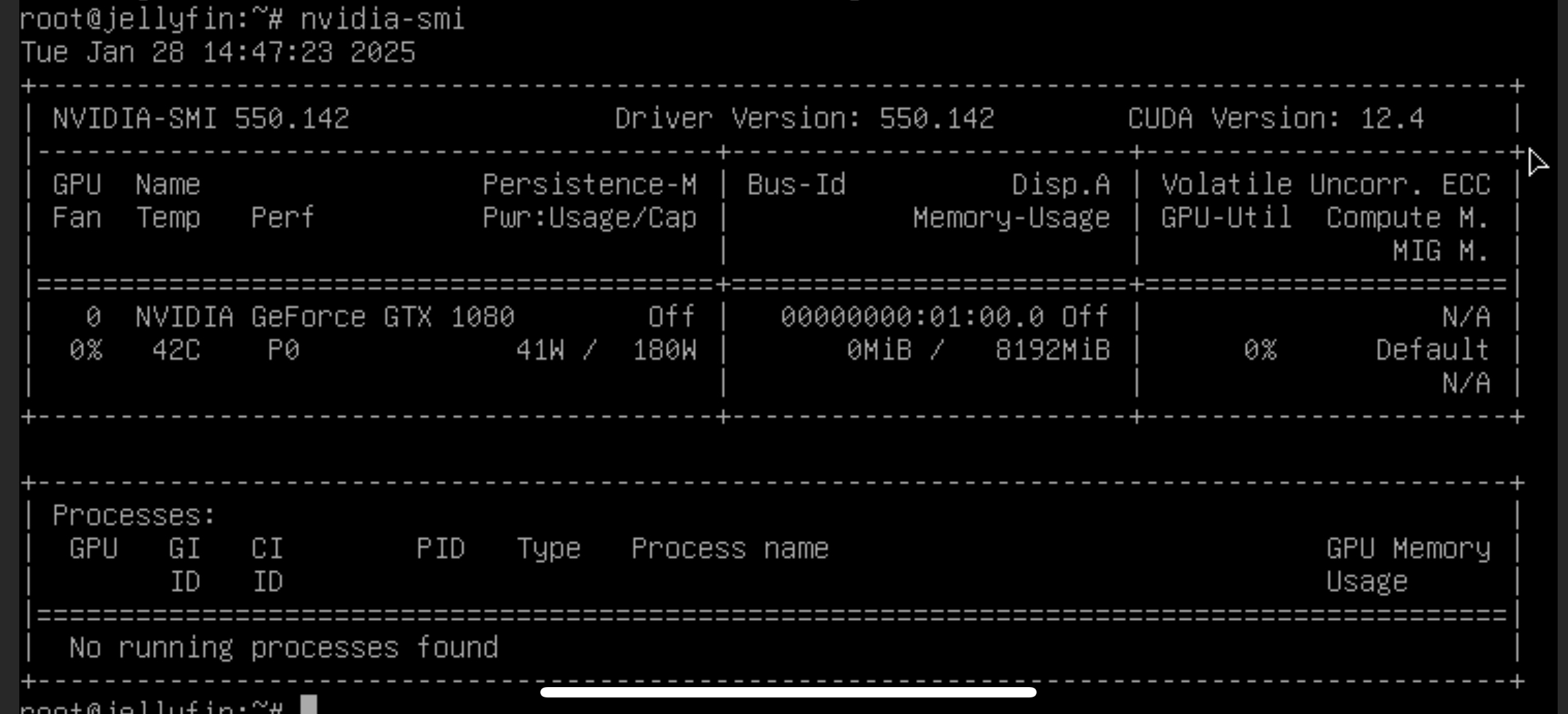

I have jellyfin running in a container on proxmox with the helper script and I have passed through a GTX1080 for hardware encoding and it was working great. Nvidia-SMI showed usage and videos would transcode when it needed to perfectly.

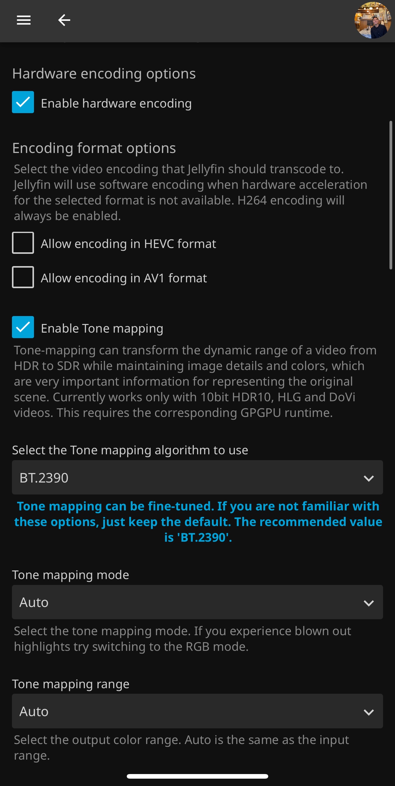

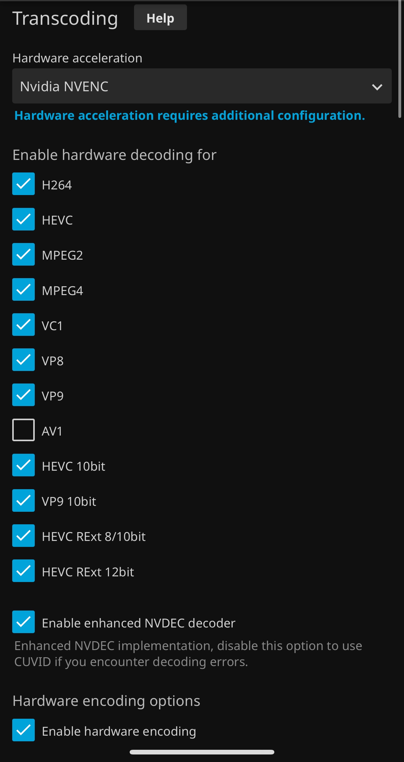

I figured my WiFi was slow at the hotel and maybe it just needed to be transcoded to something smaller, but infuse is direct play only so I tried on other iOS apps like jellyfin and swiftfin. Nothing worked. I tested a few other quality files and none of the 4K files would transcode but the lower quality videos that could be direct play work fine, until I try to force transcoding.
Not sure if the hardware acceleration just suddenly broke or if it’s even the root of the problem. But attached are my jellyfin logs and my ffmpeg logs.
Seems like “FFmpeg exited with code 187” might be the problem?
https://pastebin.com/caXq5Tk9
https://pastebin.com/B4FQWW0s
Please let me know what else I can share to help troubleshoot.
