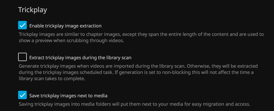

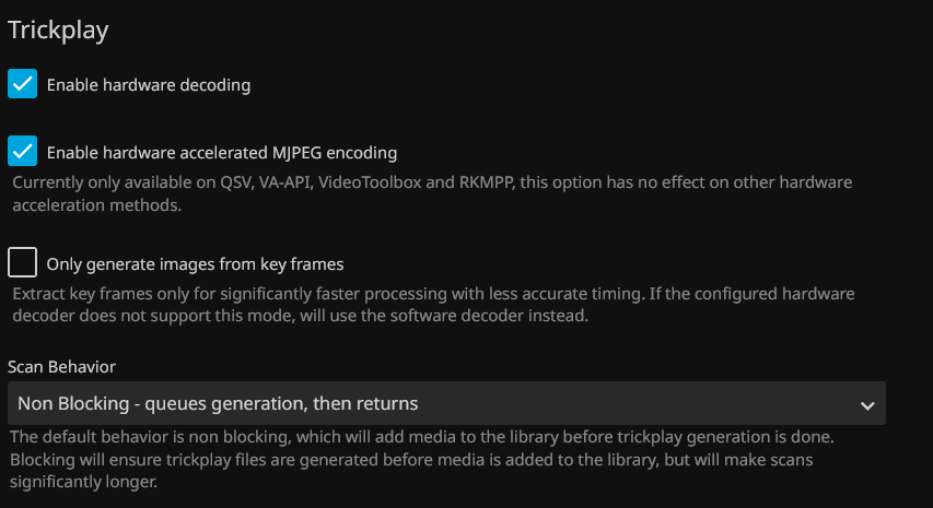

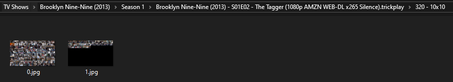

    I have enabled trickplay on my server. I made sure to enable it for each library and confirmed that trickplay images have been generated for all my media as I can see them next to my media in their folders. The issue is I cannot seem to get the trickplay images to appear when scrubbing. I know this is most likely an issue with the various clients and whether they support trickplay yet. I have tested this on the web client, the desktop client, android app, and android TV app, and none of them have trickplay images appearing when scrubbing. I have enabled trickplay generation but is there a setting to explicitly enable trickplay during playback?
