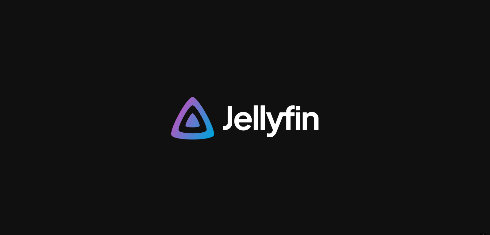

    • A full explanation of what is happening, versus what you expect to happen: So I can't get Jellyfin to work as it's stuck at logo everytime I launch it. I've already deleted my data folder, reinstalled Jellyfin, deleted my browser's cache, but nothing

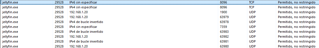

    I don't see any connection attempts in your log. Is the Windows firewall open for Jellyfin?
    Click Start > type Resource Monitor > click Network tab > expand Listening ports table
    Find jellyfin.exe on port 8096, what does it say in the firewall status column?
    supahfox
    Joined: 2024 Oct
    2024-10-18, 04:35 AM
    (2024-10-18, 04:32 AM)TheDreadPirate Wrote: I don't see any connection attempts in your log.  Is the Windows firewall open for Jellyfin?
    Ports are enabled and unrestricted

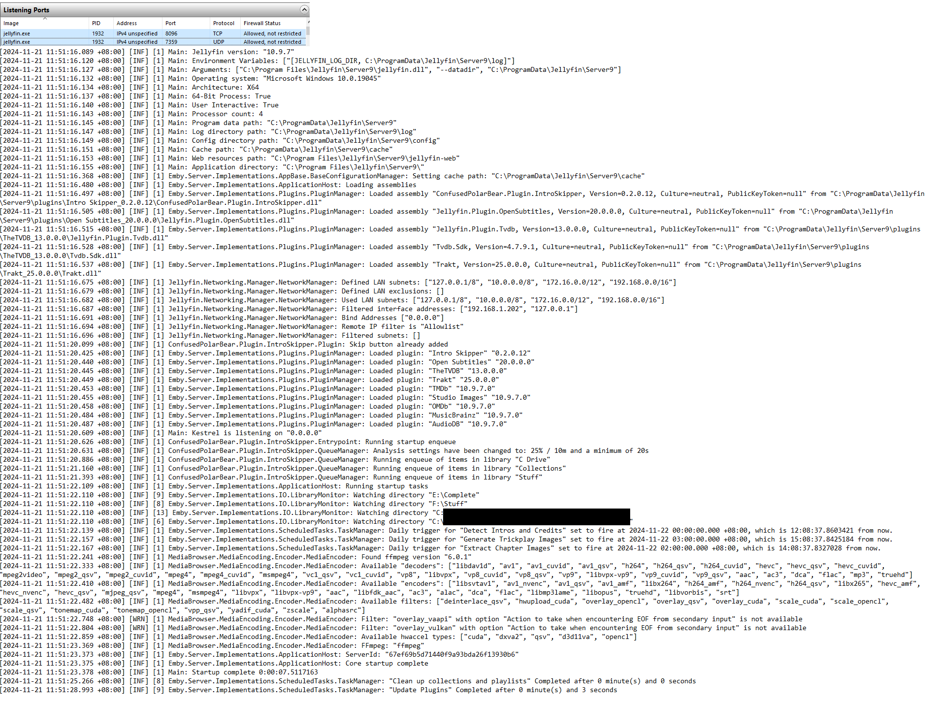

    I am facing the exact same problem today. Jellyfin was working until last night but this morning, it went kaput.
    1. Win 10, 8 GB ram
    2. Static IP
    3. Firewall listening port - allowed, not restricted
    4. Logs have no errors
    5. Not accessible using localhost or the ipaddress on the installed machine
    6. Remote comp on the local network gets the same splash screen with nothing loading
    7. I didn't change the port, didn't install anything new on the computer that might have changed the port so it's still on the default one
    This happened once in the past on my win11 machine too and I ended up blaming some update and reinstalled on win 10 machine with all updates turned off. Looks like it's a JF issue as it happens often regardless of what's going on.
    SpecialBrownie
    Joined: 2024 Nov
    2024-11-21, 04:12 AM
    update on this:
    Browser used earlier: Brave (fully updated) on both machines - stuck on the splash screen
    Browser retested on: Edge (fully updated) on both machines - JFin works
    Looks like it's a browser issue, weird!
