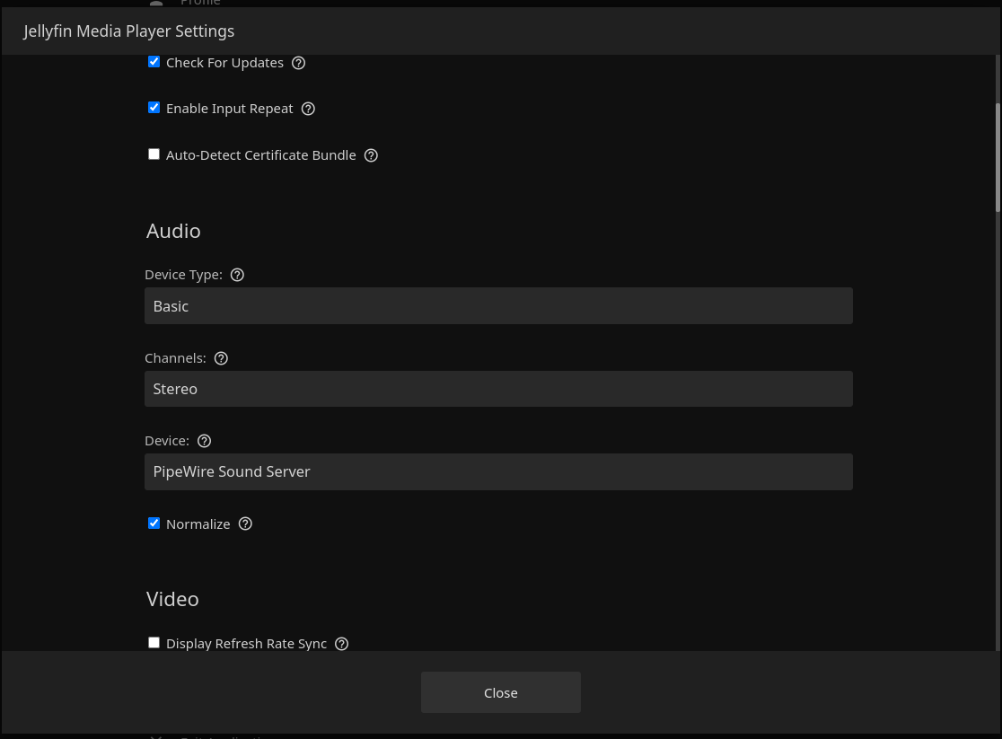

    My PC has a stereo setup.  USB DAC -> stereo headphone amp + pre-amp -> 2.0 studio monitor speakers.  JMP is set to stereo for max audio channels.  For clarification, I have stereo set in both the "playback" settings and the "client settings" with pipewire as the output device (my desktop is Linux).
    This results in a proper client side downmix.

    (2025-01-05, 06:30 PM)TheDreadPirate Wrote: My PC has a stereo setup.  USB DAC -> stereo headphone amp + pre-amp -> 2.0 studio monitor speakers.  JMP is set to stereo for max audio channels.  For clarification, I have stereo set in both the "playback" settings and the "client settings" with pipewire as the output device (my desktop is Linux).

    Is it set to stereo in both playback and in client settings? There shouldn't be much, if any, difference in how JMP downmixes between Linux and Windows clients when the settings are the same.
