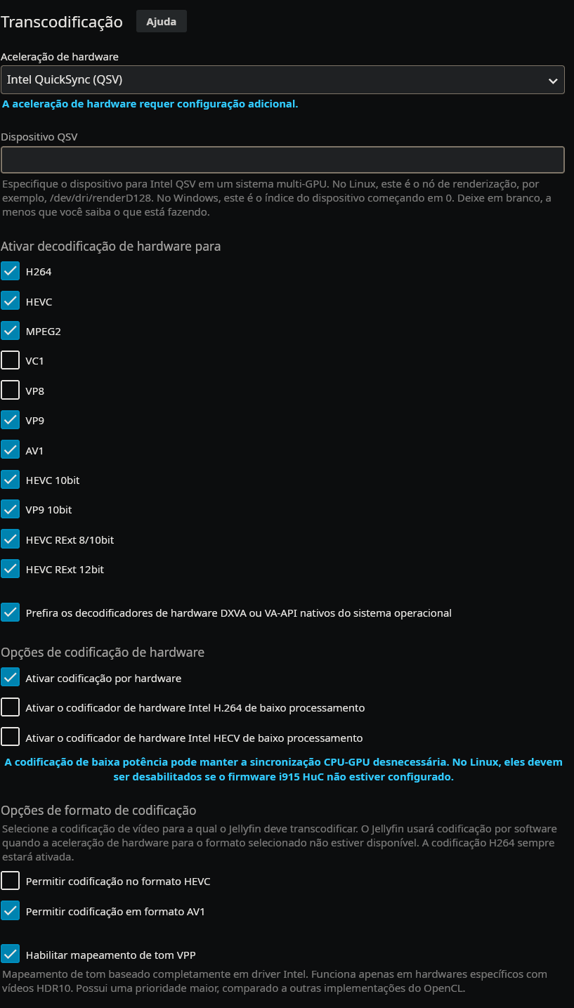

    for some reason, when i try to transcode a video (Forcing the video lower quality), it just doesnt work
    I run it in a VM ubuntu 24.04 in proxmox. arc gpu is passed correctly inside it.

    Please, what am i missing? I did everything i could but i couldnt find a fix for this
    victorvsl77
    Posts: 7
    Joined: 2025 Aug
    2025-09-16, 07:12 PM
    this is so insane, i've been trying in different VMs and i still find the same issue, with my gtx 1050 it was so easy Slightly-frowning-face
