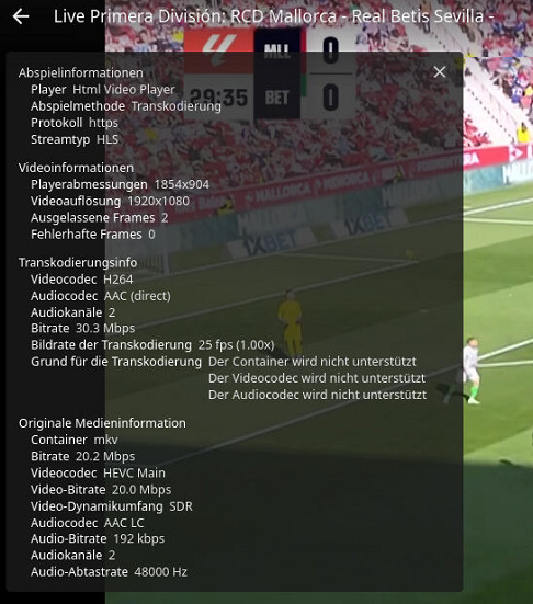

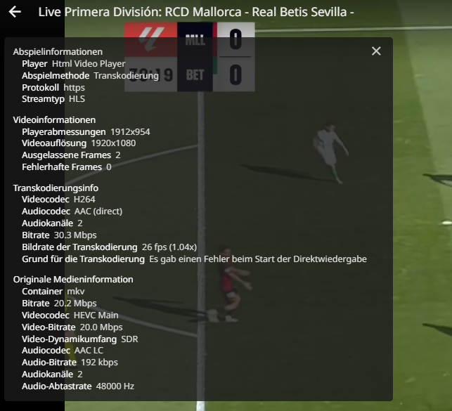

    here is a nice example which i do not understand why jellyfin is transcoding
    the stream is delivers as hvec but jellyfin transcode it back to h264...
    so it make the stream bigger that it was originally..
    This was the try to start on a Laptop with win10 (i5 8th generation) in firefox and edge
    In edge was the reason for transcode like "error at start of direct play"

    2025-01-24, 03:40 PM (This post was last modified: 2025-01-24, 03:40 PM by TheDreadPirate.)
    Did you install the HEVC decoder from the Microsoft store. For HEVC playback to work in Edge you need to have the OS level HEVC decoder installed.
    Apparently the "HEVC video extension" is no longer free?

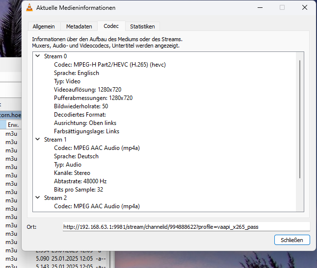

    I installed it in win11 but its still the same.... but also same scenario in FF with ubuntu (where jellyfin server runs.. so i assume that driveres are installed at least in linux.
    If i start the HEVC Stream in VLC it shows me that its running, and cpu usage in taskmaner for VLC is nearly is aroun 1-2%
    (see atached pictures)
