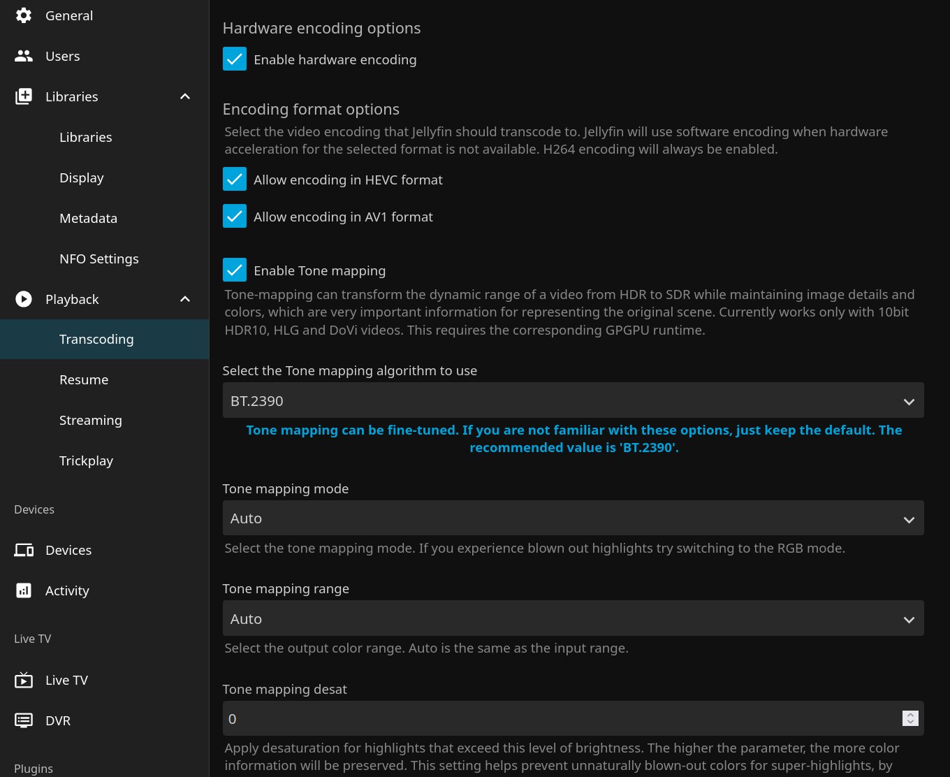

    For the record, you can check every codec box. Both decoding and encoding. And ensure tone mapping is checked. The 4000 series RTX cards support everything.

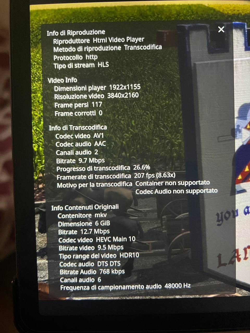

    Enabling all the settings you suggested has solved the CPU usage, on the Smartphone is all OK but the tablet still buffering even worse than before:
    Data from Jellyfin app on tablet:
    Seems that not only audio is not supported, also video from h265 to h264.
    Any ideas?

    Your screenshot is showing that it is transcoding to AV1, so I'm assuming you enabled that in the transcode settings. Did you also check the rest of the codec boxes to ensure that the GPU is decoding and not the CPU.

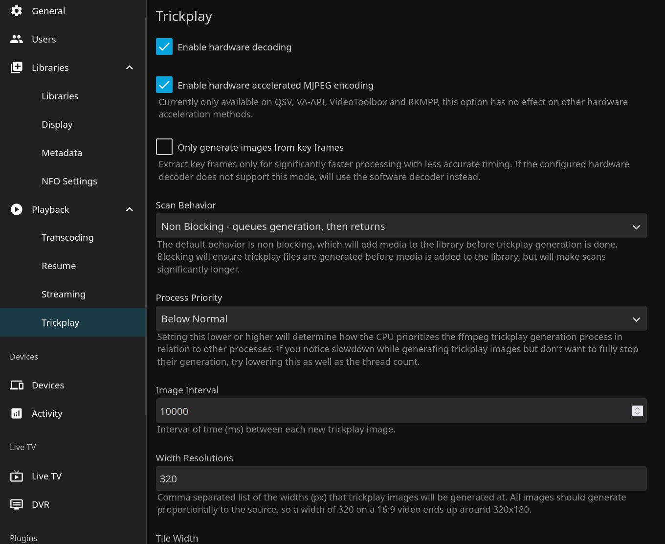

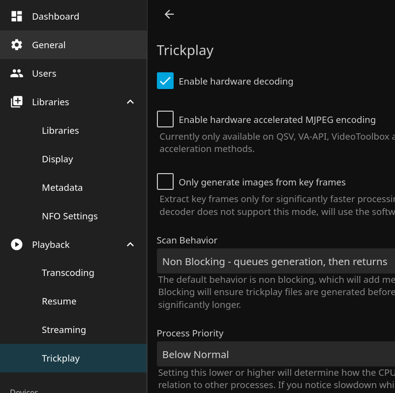

    Here are the settings:
    Thanks
