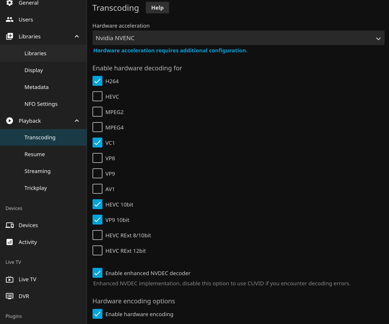

    This are the settings:

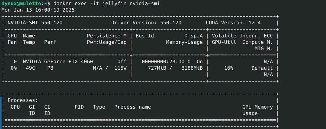

    The NVIDIA card is recognized successfully:

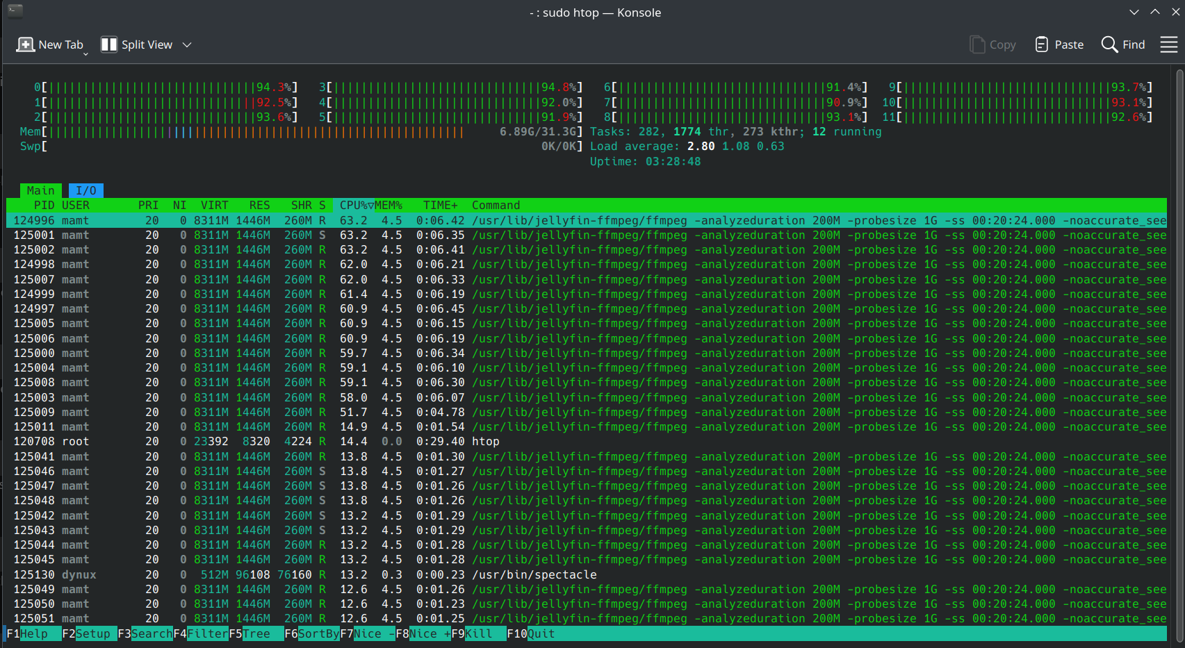

    It happens that when i try to play certain files starts transcoding that takes 100%  CPU (should not use GPU instead?) and results in buffering every 1-2 seconds:

    Are we talking 100% of a single core or 100% of the entire CPU? The audio is transcoding, which will always occur on the CPU. The video is transcoding via NVENC.
    Also, are there other background tasks that are still running that are contributing to the CPU usage?
    For the record, you can check every codec box. Both decoding and encoding. And ensure tone mapping is checked. The 4000 series RTX cards support everything.

    Here is the the CPU while playing the video:
    Enabling all the settings you suggested has solved the CPU usage, on the Smartphone is all OK but the tablet still buffering even worse than before:

    Your screenshot is showing that it is transcoding to AV1, so I'm assuming you enabled that in the transcode settings. Did you also check the rest of the codec boxes to ensure that the GPU is decoding and not the CPU.

    Here are the settings:
