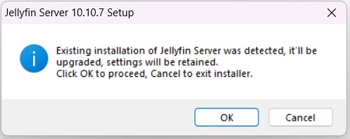

    I am unable to install the jellyfin_10.10.7_windows-x64.exe (newest Server AMD64).
    When I try to install it through the .exe it, I get the Information, that a previous version already exists.
    This version was installed on a now removed/failed drive. I have after the fact removed it through "Uninstall or change a program", which in this case just told me the file no longer exists and removed the entry.

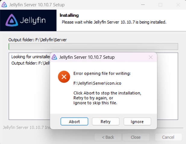

    When I continue with the install process, the installer does not prompt me for any directories and tries to overwrite/update the old install. This install is not accessible as the drive is no longer part of the computer, so it fails and does nothing.
    I have tried multiple restarts, uninstallers, registry cleaners and simply going around in both file explorer and registry "CTRL + F" any mention of jellyfin, but the problem is still there.

    Look for these registry entries and modify as needed:
    Location: HKEY_LOCAL_MACHINE\SOFTWARE\WOW6432Node\Jellyfin\Server
    Name                  Type            Data
    DataFolder          REG_EXPAND_SZ    C:\ProgramData\Jellyfin\Server
    InstallFolder       REG_EXPAND_SZ    C:\Program Files\Jellyfin\Server

    Thanks, solved the issue by simply deleting the registry entries with the incorrect data
