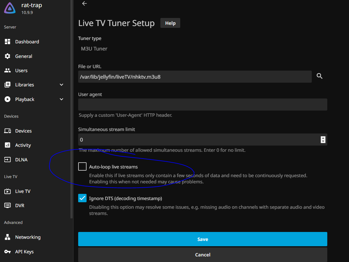

    Try enabling "Auto-loop live streams".

    (2024-08-20, 11:56 PM)TheDreadPirate Wrote: Try enabling "Auto-loop live streams".
    Thanks for the suggestion. I did test this and it makes the streams crash faster on all clients. I will do some testing with a stream buffer and see if I can get it to work for more than a few minutes.
