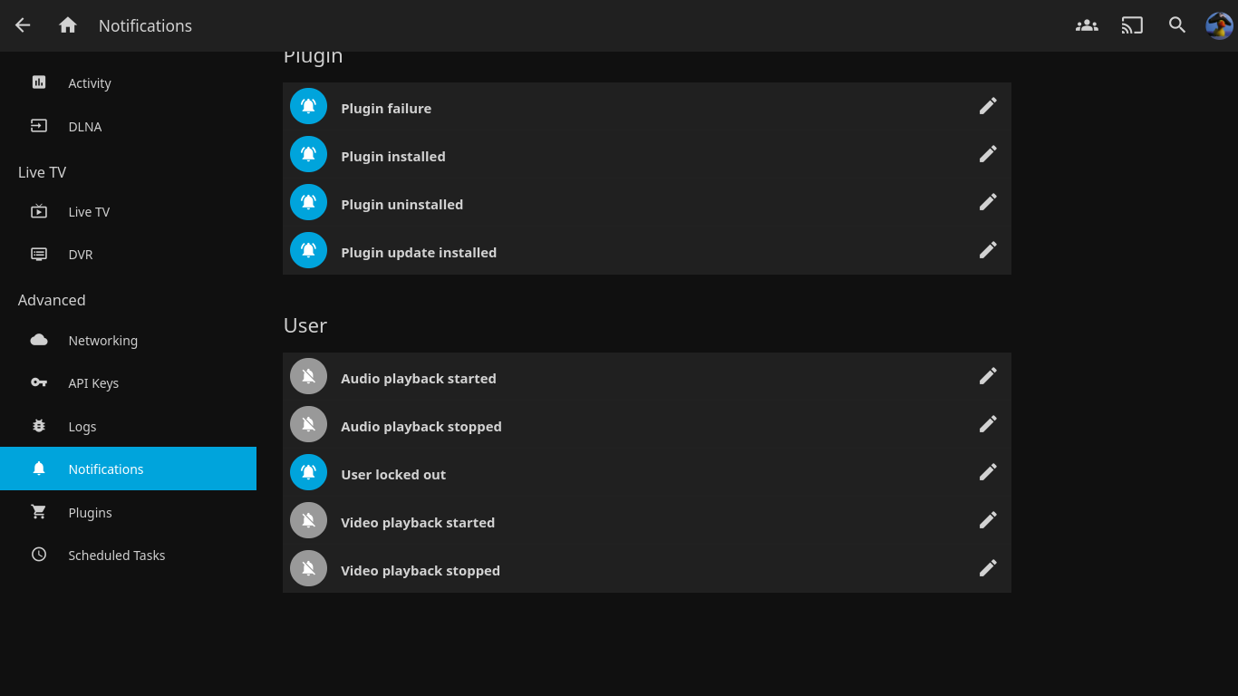

    2024-03-19, 03:07 AM
    No?  These are the notifications I see in mine.

    Yeah I have the same ones there but within the Webhook settings for Pushover integration it has a User Created notification. Why would it be there if it weren't possible to be notified?
    Or are notifications strictly prohibited to those in the official Jellyfin Notifications listings?
