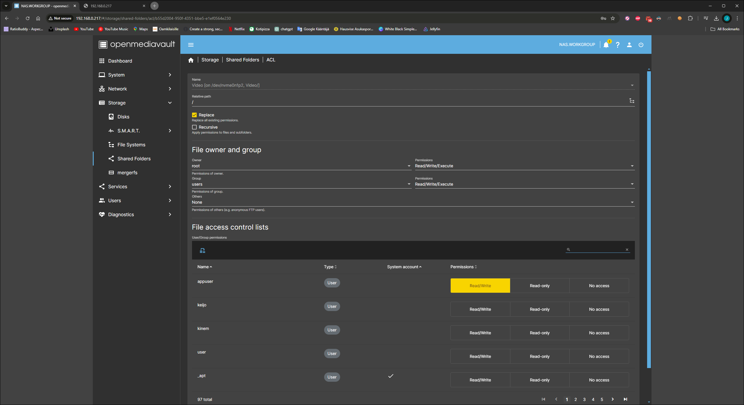

    Reputation: 464
    2024-09-08, 08:24 PM
    Does your user have R/W access to /srv/dev-disk-by-uuid-ee27ddf2-f81d-4cf9-8c4a-3eaf09e212ae/Video/config and all the folders underneath?
    Are you re-using any data from a prior install?
    Taotaka
    2024-09-09, 01:35 PM (This post was last modified: 2024-09-09, 01:56 PM by Taotaka. Edited 1 time in total.)
    The user should have access to everything under /srv/dev-disk-by-uuid-ee27ddf2-f81d-4cf9-8c4a-3eaf09e212ae/Video
    I could be using prior data since I didn't re format /srv/dev-disk-by-uuid-ee27ddf2-f81d-4cf9-8c4a-3eaf09e212ae/Video  before re installing jellyfin
    you think just deleting everything from there and re installing it would help?
    Reputation: 464
    2024-09-09, 04:39 PM
    Backup whatever is in /srv/dev-disk-by-uuid-ee27ddf2-f81d-4cf9-8c4a-3eaf09e212ae/Video/config, clear it out, and try again.
