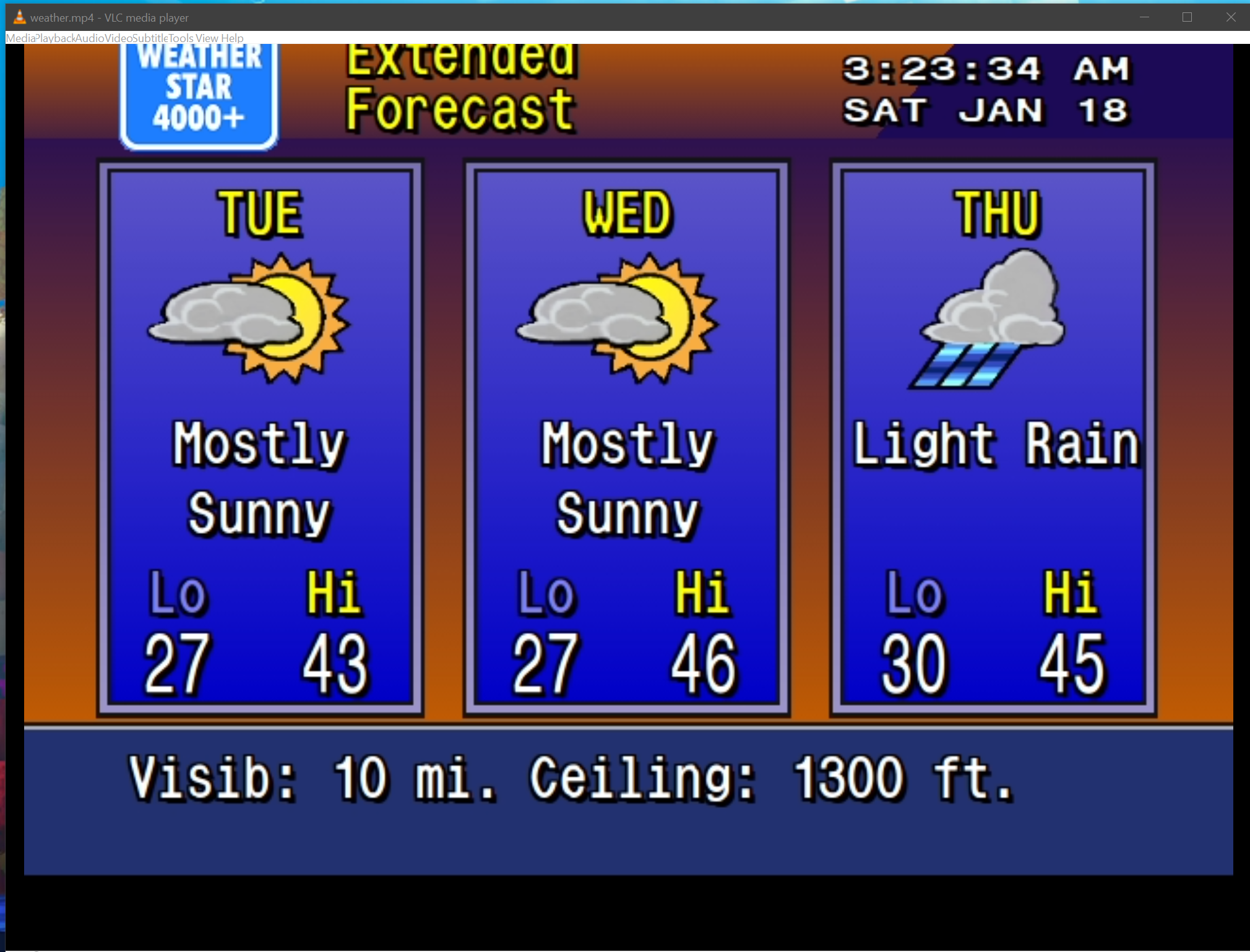

    I'm running a stream at http://[IP-ADDRESS]/weather.mp4. I have been opening it with VLC's Network Stream functionality. I'd like to be able to watch this stream on my Jellyfin deployment if possible.
    Is there any good way to accomplish this? I was poking around with the Live TV functionality but ultimately could not figure it out. Would it be possible to add this via a .m3u file?
    Thanks in advance. I hope I'm not wildly overcomplicating this.
    p.s. the weather.mp4 in question is a stream of a WeatherStar 4000+ build, screenshot attached. I think it's a cool way to check the weather.
