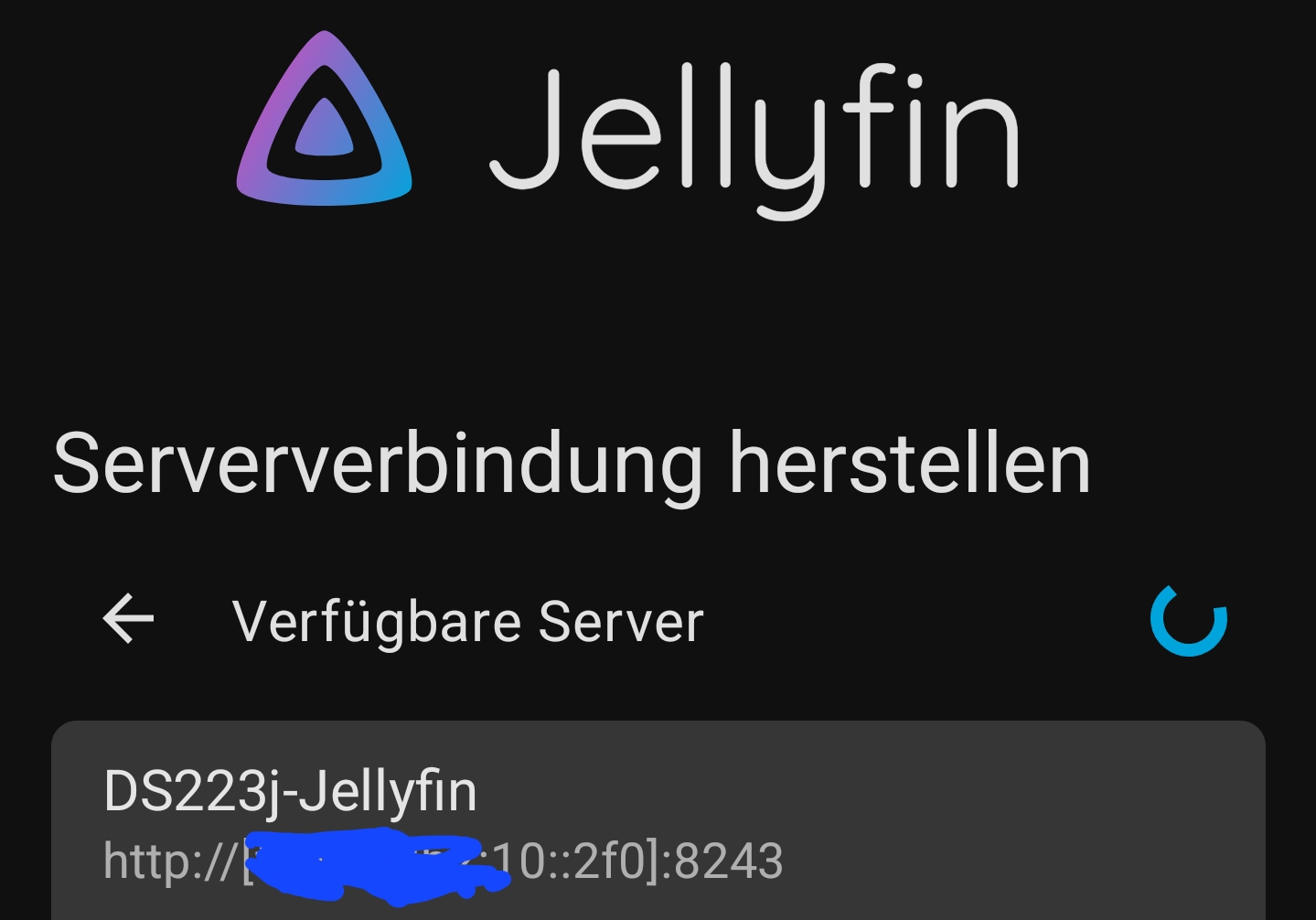

    2023-12-26, 11:04 AM
    I set the Jellyfin on ipv6 and unenabled accessing from ipv4 but with the ipv6 address I cant even access Jellyfin in my home network anymore.
    I use the Mac address of my DS223j which was found by my router in the Network.
    I also used a other Port in Jellyfin therefore i opened this changed Port.
    My Smartphone suggest to connect to this given Address but when I try I cant connect to Jellyfin.
    I also have no clue how I can connect on my pc to Jellyfin since I cant connect by using the ipv4 Address neither by the ipv6 address.
    I tried the address which was suggested by my phone on my pc but it didnt work.

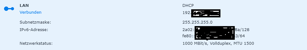

    2023-12-27, 06:15 PM
    You will probably have two IPv6 addresses.  One that begins with FE80 and one that doesn't.  FE80 is the local link address.  The other is your public IPv6 address.  You will need set up a route in your router, similar to port forwarding but not quite, to point port 8096 to your jellyfin server's public IPv6 address.

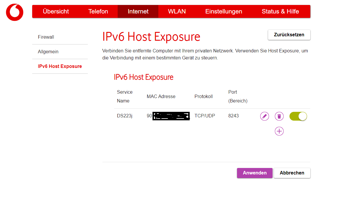

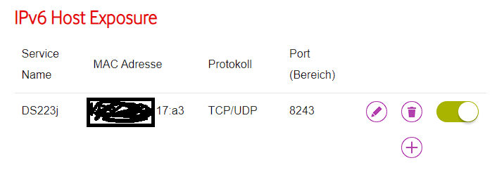

    2023-12-27, 06:59 PM (This post was last modified: 2023-12-27, 07:03 PM by Herojak. Edited 1 time in total.)
    The right ipv6 Address is 2a02 .... /128 ?
    Where i can point the port to my jellyfin Server.
    Is it the ipv6 host exposure like in the screenshot or is it somewhere else in the router settings?
