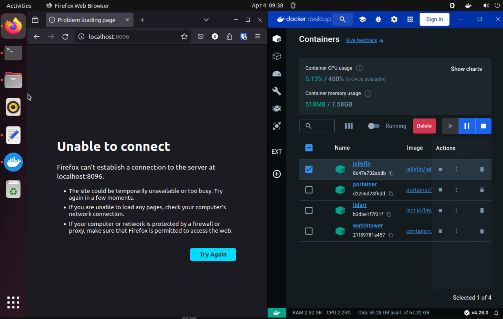

    The problem is that they can't get to the GUI, even when using localhost:8096.

    I may have found the problem. I just noticed this in your docker inspect.
    For some reason "CgroupnsMode" is set to private instead of host. Pretty sure it should be "host" if the network type is also set to host. I wonder if this is a bug in the version of docker you are running.
    Add this to your docker run command.
    --cgroupns host
    You can also try setting up a docker compose file to start and stop your container.

    Update:
    Using the string format for the configuration got it to actually use the same subnet but for some reason I still can't access it.
    Output of the container:

    Output of docker inspect jellyfin:
    toor@docker:~$ docker inspect jellyfin
            "Id": "8c47e732abdbd377412086c8fdd55cac4165efb82cd64c6838cd2a94a0996673",
            "Created": "2024-04-03T19:52:05.343344325Z",
            "Path": "/jellyfin/jellyfin",
            "Args": [],

    #26
    2024-04-04, 02:45 PM
    See my post just prior to yours.
    Add this to your docker config for Jellyfin.
    --cgroupns host
    Check whether your other containers are cgroupnsmode=host.
    ghostkjb
    Posts: 14
    Joined: 2024 Apr
    #27
    2024-04-04, 02:59 PM
    I GOT IT!!
    I was cross comparing to my other containers and I realized that for some reason all of the others that were working were on bridged network. (I've never used bridge before that I know of.)
    So I put the container on bridged and passed through all of the ports listed on Jellyfin website!
    Thank y'all so very much for your help! I'm glad I was able to specify the subnet with: <LocalNetworkSubnets><string>192.168.1.0/24</string></LocalNetworkSubnets>
