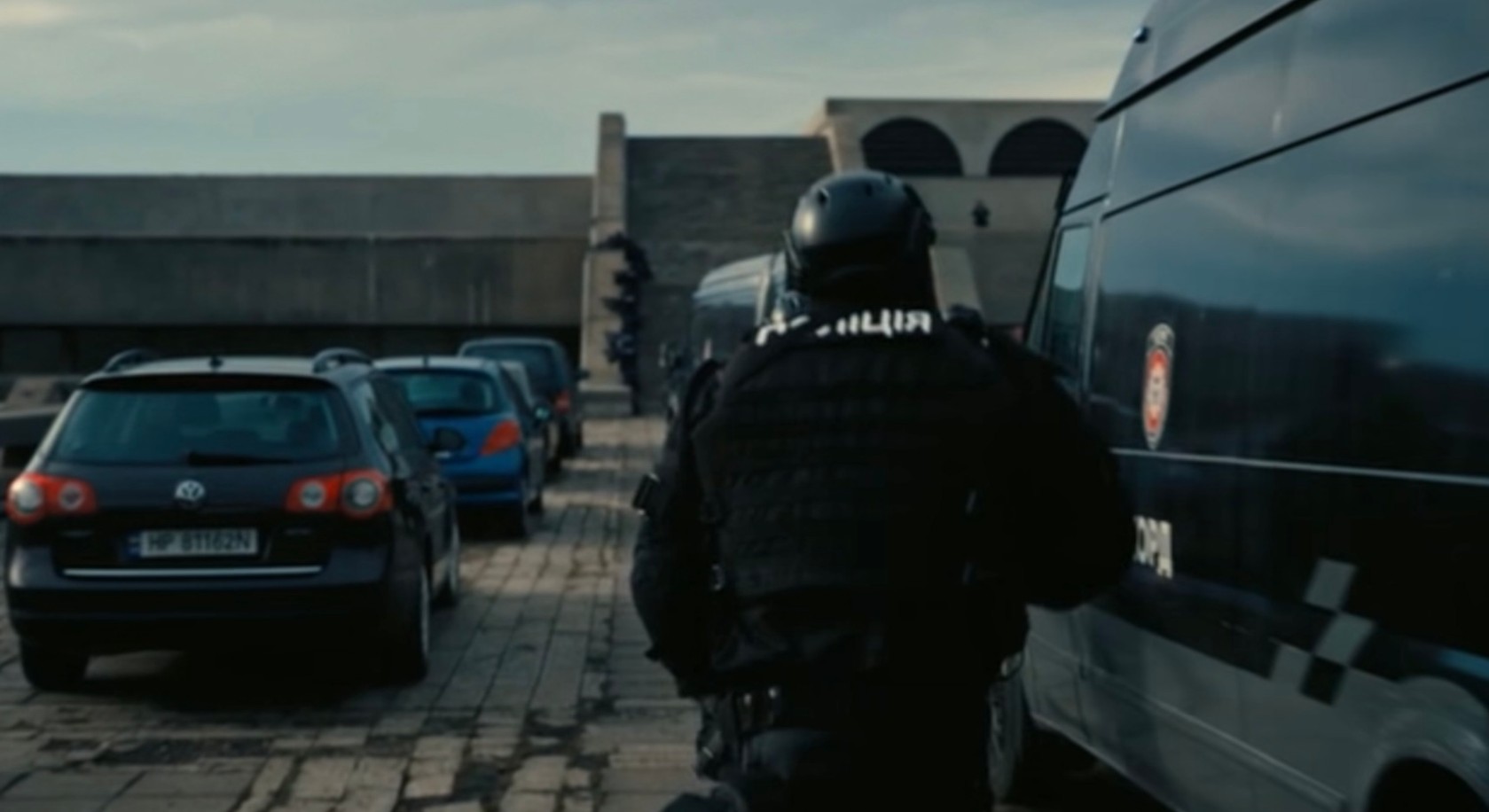

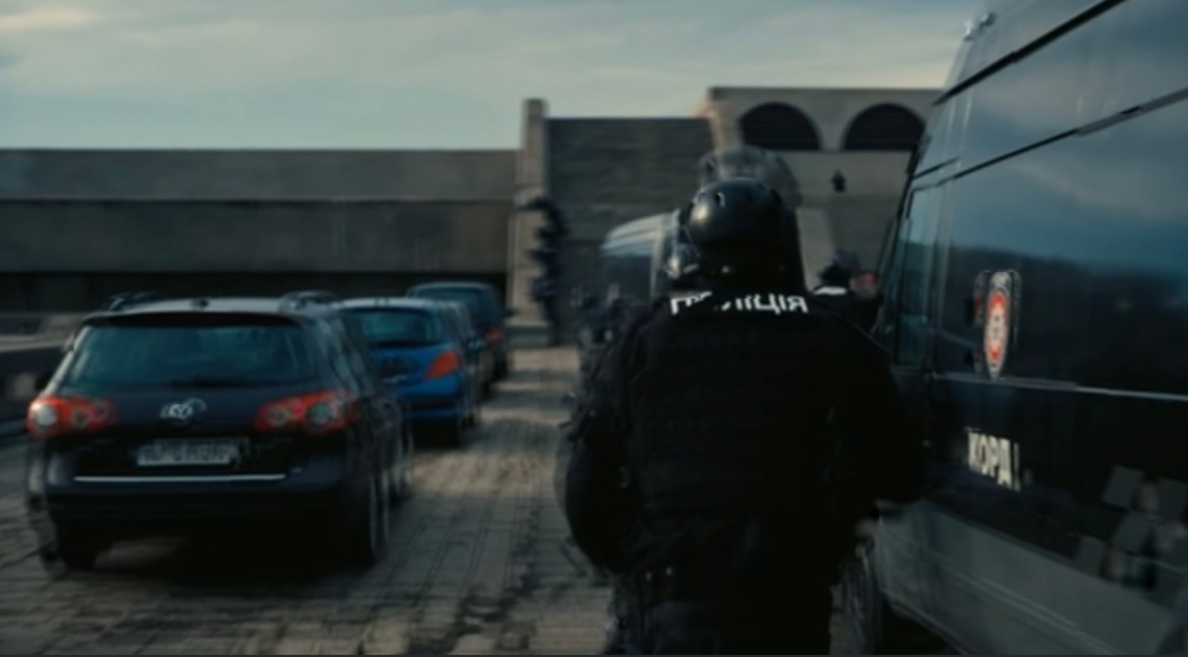

    Like I said it's about every 5 seconds or so that I get a few bad frames in a row and then it goes back to normal. If you look at the license plate on the left you can see the loss in quality pretty easily.

    One thing I missed from your initial ffmpeg log was that you don't have hardware decoding enabled. That shouldn't change the quality of the transcode, but it would significantly reduce the CPU load since it would offload that to the iGPU.
    Not sure what is going on with the "double frame" in the transcode. I've never seen that on my Arc GPU.
    Is the Intel graphics driver fully up to date?

    Oh yeah I can enable hardware decoding and try it again. Maybe there’s a chance that improves it somehow. Yeah I just checked my drivers and they are all up to date.

    I enabled hardware decoding and it looks like that fixed it! Thank you!
