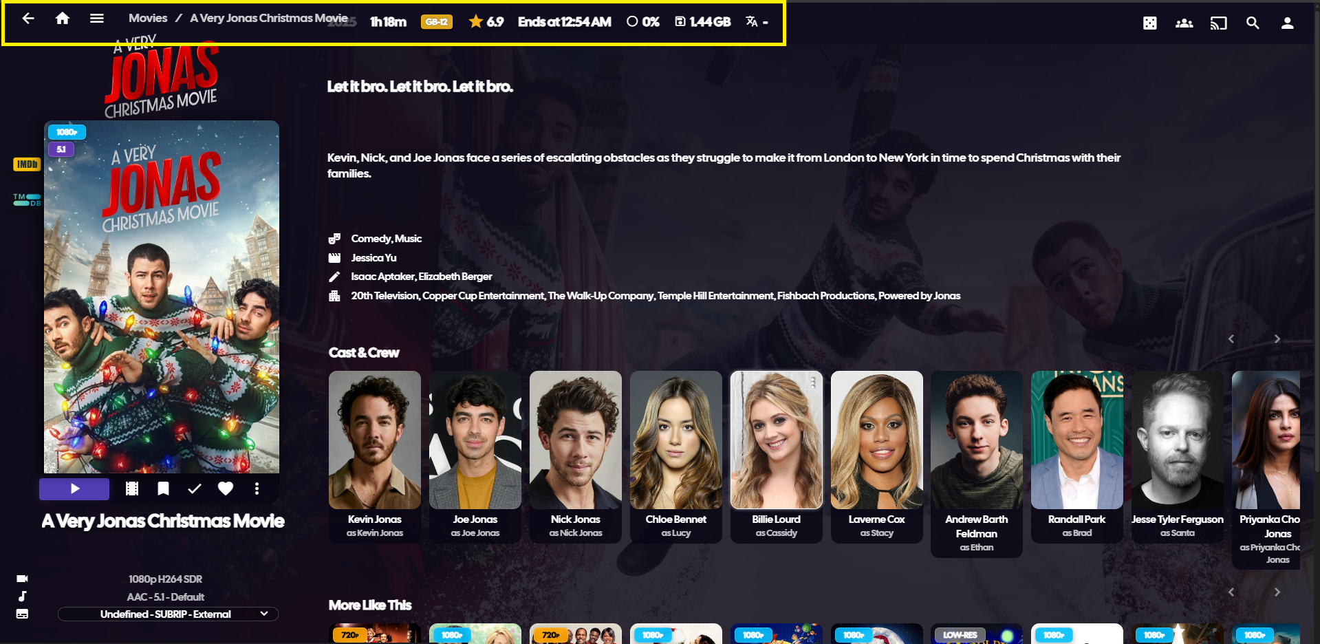

    11 hours ago (This post was last modified: 10 hours ago by 2020. Edited 6 times in total.)
    Ill give it another try. Im using the new theme since I need to check all the code in detail anyway, if not ill need to go back to using the old theme and make custom changes.
    what I dont understand is im using you code but why ls it stuck like this, the header wont come down. is it a recent update ?
    @import url("https://cdn.jsdelivr.net/gh/tedhinklater/finimalism@main/finimalism10.11.css");
    @import url("https://cdn.jsdelivr.net/gh/tedhinklater/finimalism@main/no-animation.css");
    .layout-desktop #indexPage .itemsContainer,
    .layout-tv #indexPage .itemsContainer,
    .layout-desktop #itemDetailPage .verticalSection.detailVerticalSection.moreFromSeasonSection.emby-scroller-container .scrollSlider.focuscontainer-x.itemsContainer.animatedScrollX,
    .layout-tv #itemDetailPage .verticalSection.detailVerticalSection.moreFromSeasonSection.emby-scroller-container .scrollSlider.focuscontainer-x.itemsContainer.animatedScrollX,
    .layout-desktop #castCollapsible .scrollSlider.focuscontainer-x.itemsContainer.animatedScrollX,
    .layout-tv #castCollapsible .scrollSlider.focuscontainer-x.itemsContainer.animatedScrollX,
    .layout-desktop #guestCastCollapsible .scrollSlider.focuscontainer-x.itemsContainer.animatedScrollX,
    .layout-tv #guestCastCollapsible .scrollSlider.focuscontainer-x.itemsContainer.animatedScrollX,
    .layout-desktop #similarCollapsible .scrollSlider.focuscontainer-x.itemsContainer.similarContent.animatedScrollX,
    .layout-tv #similarCollapsible .scrollSlider.focuscontainer-x.itemsContainer.similarContent.animatedScrollX,
    .layout-desktop #specialsCollapsible .scrollSlider.focuscontainer-x.itemsContainer.animatedScrollX,
    .layout-tv #specialsCollapsible .scrollSlider.focuscontainer-x.itemsContainer.animatedScrollX {display: flex !important; flex-wrap: nowrap !important; gap: unset;}
    #indexPage button[data-direction="left"], #indexPage button[data-direction="right"] {opacity: 0.5; padding-right: 1em;}
    #itemDetailPage button[data-direction="left"], #itemDetailPage button[data-direction="right"] { opacity: 0.5; }
    .verticalSection[data-type="MusicAlbum"] .itemsContainer.padded-right.vertical-wrap { flex-wrap: wrap! important;}
    .layout-desktop #itemDetailPage .scrollSlider.itemsContainer, .layout-tv #itemDetailPage .scrollSlider.itemsContainer { flex-wrap: nowrap !important; white-space: normal !important;}
    you code  did not work
    Quote:for the my media cards try this, it's a little less specific Code:
    .layout-desktop .MyMedia .card.overflowBackdropCard.card-hoverable.card-withuserdata {width: 18em !important;}
    but for some reason this did
    .layout-desktop #indexPage .itemsContainer .card.overflowBackdropCard.card-hoverable.card-withuserdata {
        width: 18vw !important;
