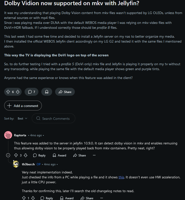

    I found posts here and on Reddit of users getting DV from mkvs through Jellyfin after an update this autumn. I'm just trying to figure out how they did it as none of the posts really explained it too well. There is also Kodi that works for playing DV on LG but it's quite buggy.

    My TV plays the file in HDR10 by default so no need to remove DV. I did attach a screenshot of people on Reddit talking about DV working on jellyfin on webos on mkvs. It's not the only post online that claims that mkvs can be played in DV on webOS through Jellyfin. I tried Kodi and it worked for a couple of days until it didn't. I might just give up and enjoy HDR10 and not bother with DV.

    Just to be clear, DV does work on WebOS with the Jellyfin app so long as the profile is 8 or 5; the screencap attached seems to be talking about DV 8 and DV 5 working, not 7. If you provide your TV model we could take a look at the specs and confirm what it does support, but as DP mentioned profile 7 has been mostly relegated to BluRay players or similar external hardware devices.

    (2024-12-22, 07:44 PM)Host-in-the-Shell Wrote: Just to be clear, DV does work on WebOS with the Jellyfin app so long as the profile is 8 or 5; the screencap provided seems to be talking about DV 8 and DV 5 working, not 7. If you provide your TV model we could take a look at the specs and confirm what it does support, but as DP mentioned profile 7 has been mostly relegated to BluRay players or similar external hardware devices.
