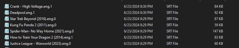

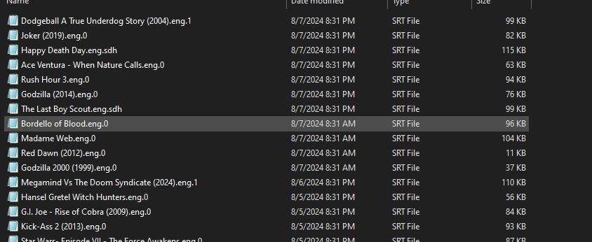

    I have every day if you look at my pictures. It is downloading the subtitles for ones I already have.  See picture. Every day it just grabs the same subtitles for things I already have subtitles for since you can see in my second picture every single one ends with .eng.#.  The number indicates that there is already a subtitle and so it just adds a .0 or .1.  Look at the third picture called Austin.  It is the EXACT SAME FILE that it has downloaded, 2 on the same day. Is there a specific setting I am missing that needs to be set so it doesn't keep downloading the same subtitles for ones already with a set of subtitles since it keeps downloading something I already have? It also doesn't even notice new movies and adds subtitles for them since it seems to think that it has no subtitles.

    Huh.  I don't use OpenSubtitles in my main instance, but I do in my test instance.  And it is also duplicating downloads.
    [2024-08-07 20:28:27.985 +00:00] [INF] [93] Jellyfin.Plugin.OpenSubtitles.OpenSubtitleDownloader: Remaining downloads: 18
    [2024-08-07 20:28:28.208 +00:00] [INF] [74] MediaBrowser.Providers.Subtitles.SubtitleManager: Saving subtitles to "/media/storage2/testShows/Sailor Moon/Season 1/s01e39.eng.0.srt"
    -rw-rw---- 1 chris    jellyfin    22868 Aug  7 16:28 s01e39.eng.0.srt
    -rw-rw---- 1 chris    jellyfin    22868 Jul 22 13:36 s01e39.eng.srt
    -rw-rw---- 1 chris    jellyfin 797695327 May  2 21:05 s01e39.mkv
    -rw-rw---- 1 chris    jellyfin      6730 Aug  4 12:41 s01e39.nfo
    This definitely looks like a bug in the plugin.
    Go ahead and report an issue on the plugin's git.
    https://github.com/jellyfin/jellyfin-plu...les/issues
