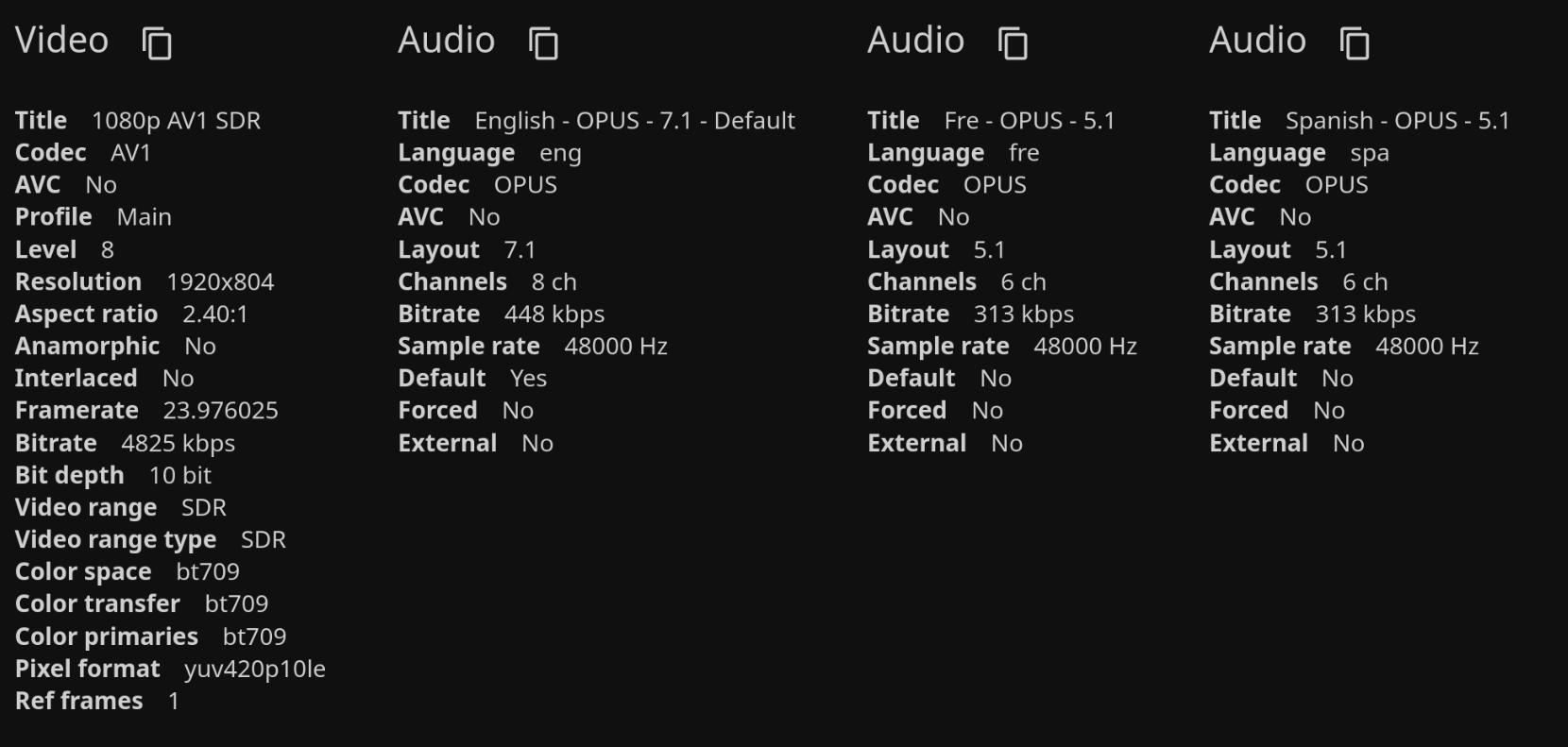

No audio on Opus 7.1 videos when running through Webos client. The video plays and runs fine, except it is completely silent. It is running through direct play.
I get the feeling, since it doesn't work via the usb drive, that there really isn't anything I can do aside from remuxing the files. But I wanted to ask if there was a fix/if it was possible to transcode only the audio of a file since my NAS isnt good enough to do AV1 to 264 without stuttering.
Additionally, since jellyfin is allowing direct play to a format that may not be supported by hardware, I wanted to check if this was an issue with jellyfin.
Characteristics I have noticed:
TrueHD 7.1 files play audio successfully. I have not been able to try with other audio codecs at this time.
Switching to other languages on the same file causes audio to play successfully when the new language is in 5.1.

Information about audio files:
attached is the details about a non-functioning audio file

Description of Issue:
