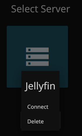

    I'm having trouble doing that. I clicked shutdown and then renamed the folder. Upon doing that I'm locked out from being able to load the server and create a new account.
    I renamed it back to "Server" so I could load it and make a new account. But that has the same problem as my original account.
    I also shutdown the server by exiting via the systray icon but it made no difference.
    How can I make a new account from scratch? When I rename the folder it keeps on blocking me with this error:
    We're unable to connect to the selected server right now. Please ensure it is running and try again.
    I've got that error everytime but usually I just attempt it two or three times and it works. But now renaming the folder it won't let me load it.
    Posts: 1,455
    Reputation: 81
    #17
    2025-03-09, 05:10 PM
    When you switch servers, the old server gets stored in the cache. You need to click on the Server icon select delete (this only deletes it from the browser cache), then browse the root URL directory: http://localhost:8096
