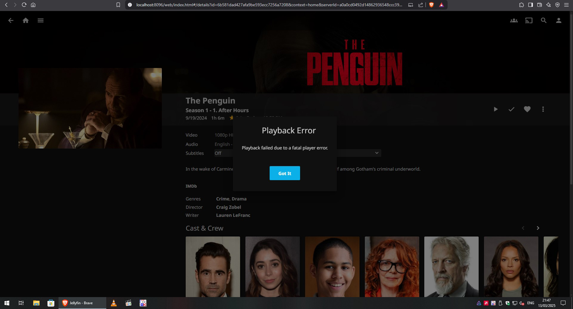

    2025-03-14, 06:13 AM (This post was last modified: 2025-03-14, 07:53 AM by Massacher. Edited 2 times in total.)
    I have given all the folders full permission (Movies and TV shows). Given ffmpeg and frobe full permission. I've even given the transcode folder full permission.
    But I have discovered that I can't even play them on the server. I click into a movie and press play and then this error:
    Something is seriously wrong. I tried trickplay too. I enabled hardware decoding on the server and enabled trickplay on the app on my tv. No difference. Still won't play but I can see it play in the dashboard.
    I do use external players like VLC, Nova player and a few others. But I disabled those temporarily to see if the Jellyfin internal player would work. Nope. Still the same issue. Black screen with a spinning circle sometimes.
    I don't know what else to do. I've tried everything I can think of and the suggestions on here. I'm still at square one. Nothing plays.
    Here are the logs from today. One direct stream and one transcode.
    Also a log from just starting the server without opening the browser. And then one more with the browser open (in the zip).

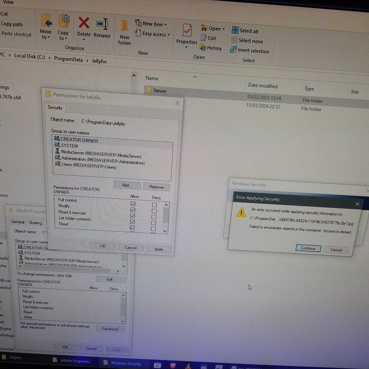

    2025-03-15, 05:52 AM (This post was last modified: 2025-03-16, 08:16 AM by Massacher. Edited 2 times in total.)
    (2025-03-14, 01:15 PM)TheDreadPirate Wrote: And you've also tried running the tray app as admin?  It still looks like there are a bunch of permission issues.
    And to clarify thunderbolt's suggestion, you should be granting YOUR user full access to Jellyfin's programdata folder.
    Yes I right clicked the desktop icon and selected Run as administrator.
    I granted access to all users. Everything in the security tab. Everything (all Groups and usernames), have full control in Jellyfin's programdata folder and the full folder of the app itself too.
    Ignore that error. There was some issues with Inheritance and child object permissions which I figured out.
    I even disabled the windows firewall to see if that was the issue. But it made no difference.
