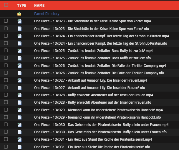

    Screenshot attached shows folders in my filesystem

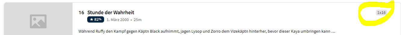

    Can you try renaming the folders back to "season 01" and so on?  I can't remember if it is required, but I noticed that in TMDB that even when you are looking at the story arc/sage ordering that there are still markers indicating season and episode numbers.

    Your season number/episode number scheme does not conform to our docs
    Particularly the "13x025" part. Should be s13e025. Additionally, you need to make sure the numbers match what is in your metadata source. For example, in the screenshot I shared in my last post you will notice that first episode of sage 2/"season 2" is 62. It is using both season numbers with absolute episode numbers.
