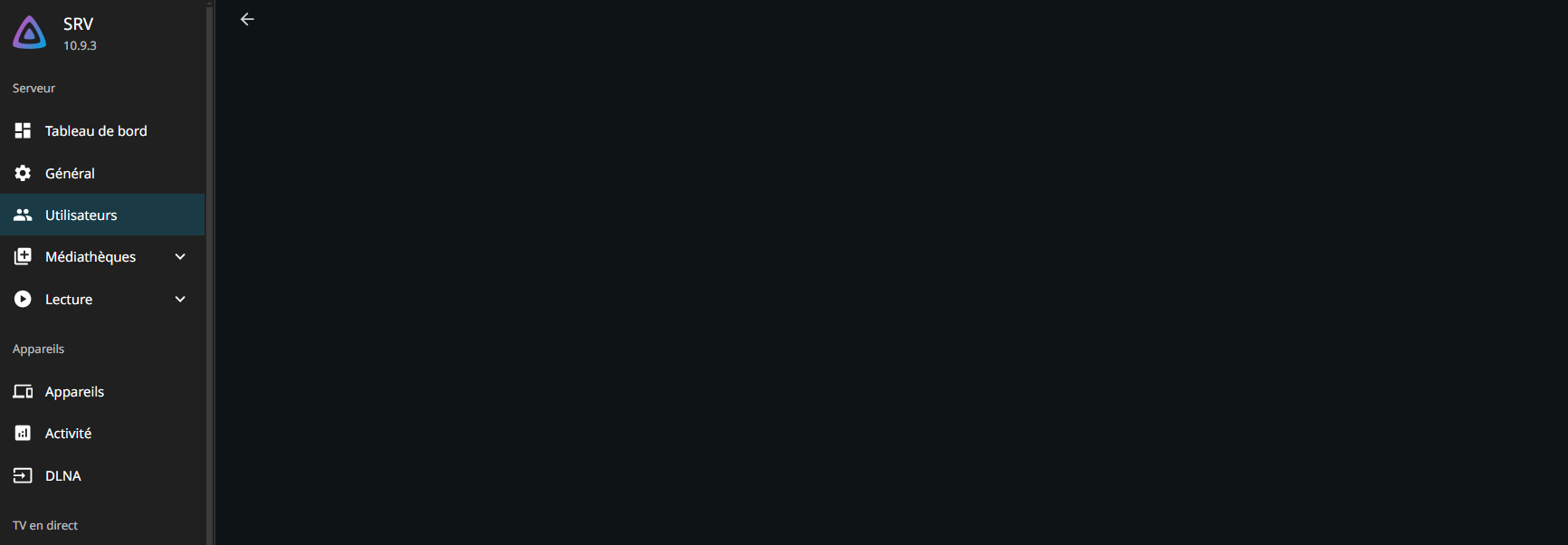

    I've been unable to access the users tab for a few days now. I'm using the latest Windows version of Jellyfin, and restarting the Jellyfin server hasn't solved the problem.
    2024-07-23, 03:08 PM
    When you say latest, I'm assuming 10.9.8 but your browser says 10.9.3.
    Can you try pressing ctrl+f5 or clearing your browser cache?

    Hello @TheDreadPirate
    I did update to the latest version, my bad.
    I had also tried deleting the cache, without any success.
    Would you have another idea?

    Hello @Efficient_Good_5784
    I've just installed Jellyfin Media Player 1.11.1 for Windows and I'm having the same problem accessing the user page.
    I don't know what to try to access it, if you have other solutions?

    What's strange is that with Jellyroller, I was able to create a user in CLI (I logged in with this new user without any problem), I gave him admin rights in CLI too, it worked fine but still no access to the “users” section on the web interface.
    I'm a bit worried about reconfiguring the admin, won't any of the data be lost?
    Thanks a lot

    I've just tested it and I can't stop at the admin user configuration, I'm obliged to continue until I've configured the libraries.
    I've also just noticed that via the inspect -> network tab on my browser, in the “users” response I can see my users, the only problem is the display of the users tab.

    I've just deleted my CSS and now I have access to my users again. All I have to do is remove what's blocking the user management display.
