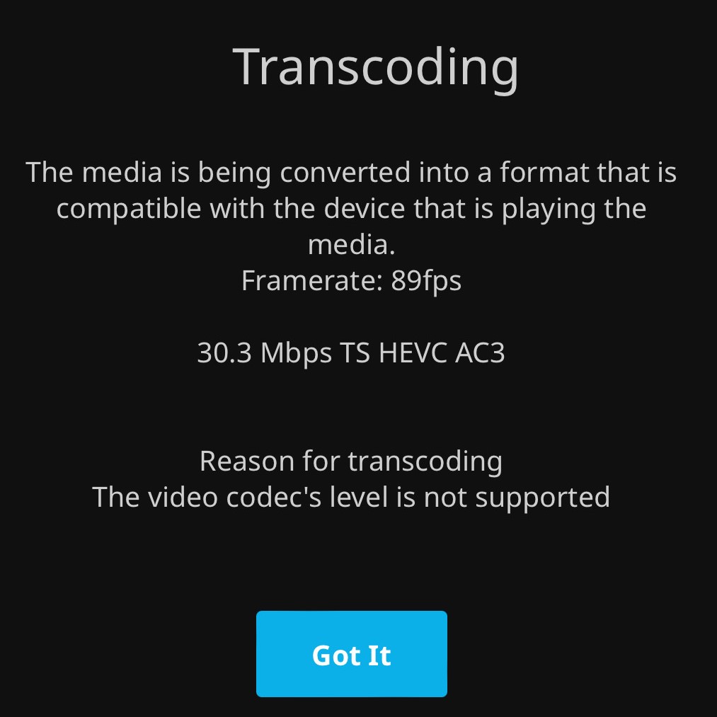

    For that specific file, the problem is most likely related to profile levels. Although the shield can play it, the checks are failing, causing Jellyfin on Android TV to assume your device can't handle it and triggering a transcode. You can find more details in this issue.

    Could you check why that file is transcoding? I'm not sure how it shows up in the logs, but if you play the file and go to your dashboard, clicking the info icon for the playing media should provide the reason.

    (2024-08-21, 05:47 PM)theguymadmax Wrote: Could you check why that file is transcoding? I'm not sure how it shows up in the logs, but if you play the file and go to your dashboard, clicking the info icon for the playing media should provide the reason.
    That is almost an exact screenshot of what i'm seeing, the same message you are showing there.

    2024-08-22, 07:28 PM
    Here is the screenshot requested, i've turned off sub's and still nada it transcodes
