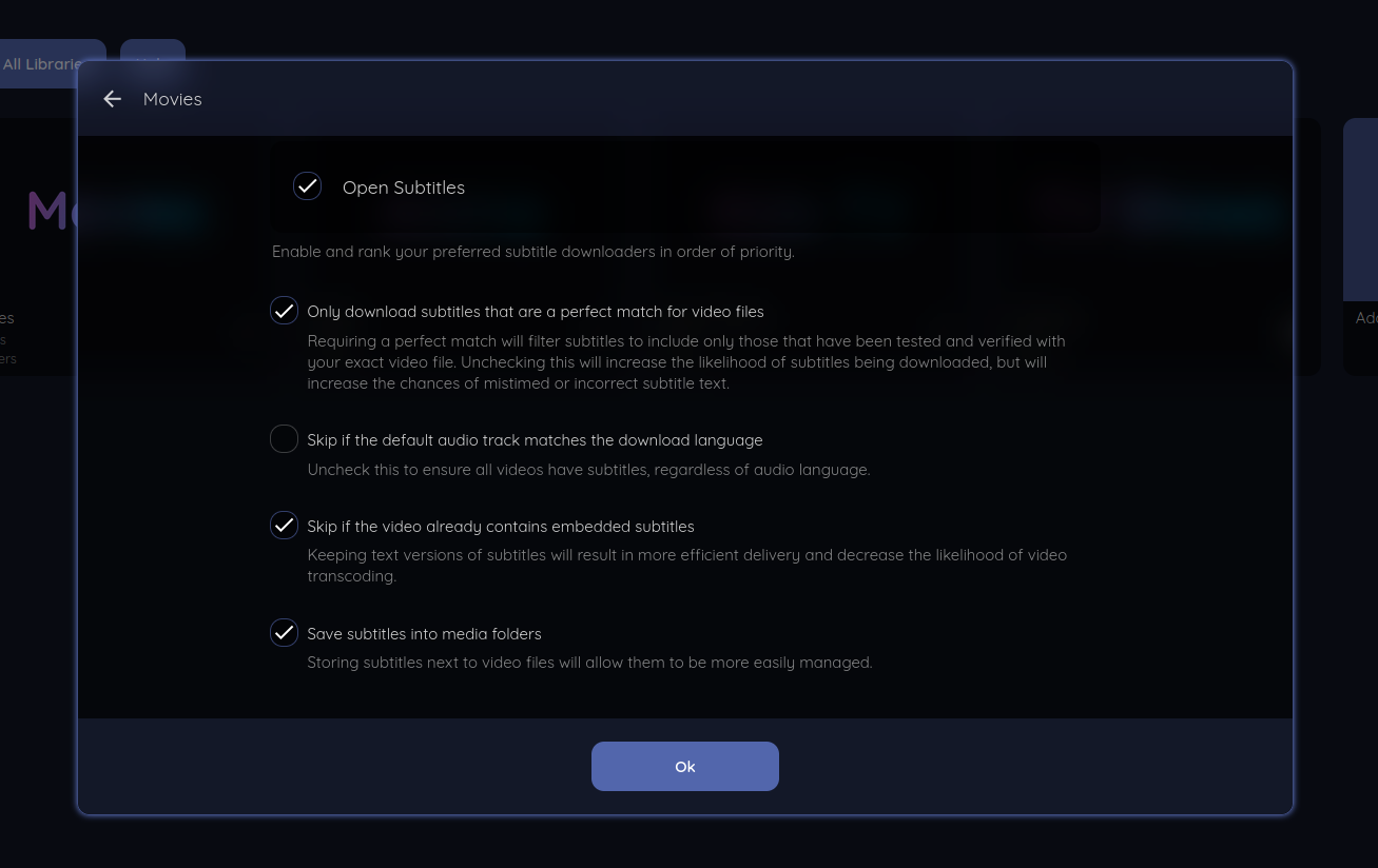

    2024-07-24, 03:53 PM
    Can you show me a screenshot of the subtitle downloader section of your library config?

    2024-07-24, 03:59 PM
    Here is the log once it completes and the subtitles settings. This is the same for all libraries.
    2024-07-24, 04:15 PM
    Do your videos have embedded subtitles?

    2024-07-24, 04:17 PM (This post was last modified: 2024-07-24, 04:18 PM by treyzer.)
    Some do, not all of them. I use the Subtitle Extract for those. Figured skipping it with that and manually doing subtitle extract (also being ran with scans and at every night at 12) should be fine.
    shows/movies usually have embedded or a srt file so those are easy. It's the shows (like One Piece for example) that have neither that is the main headache
