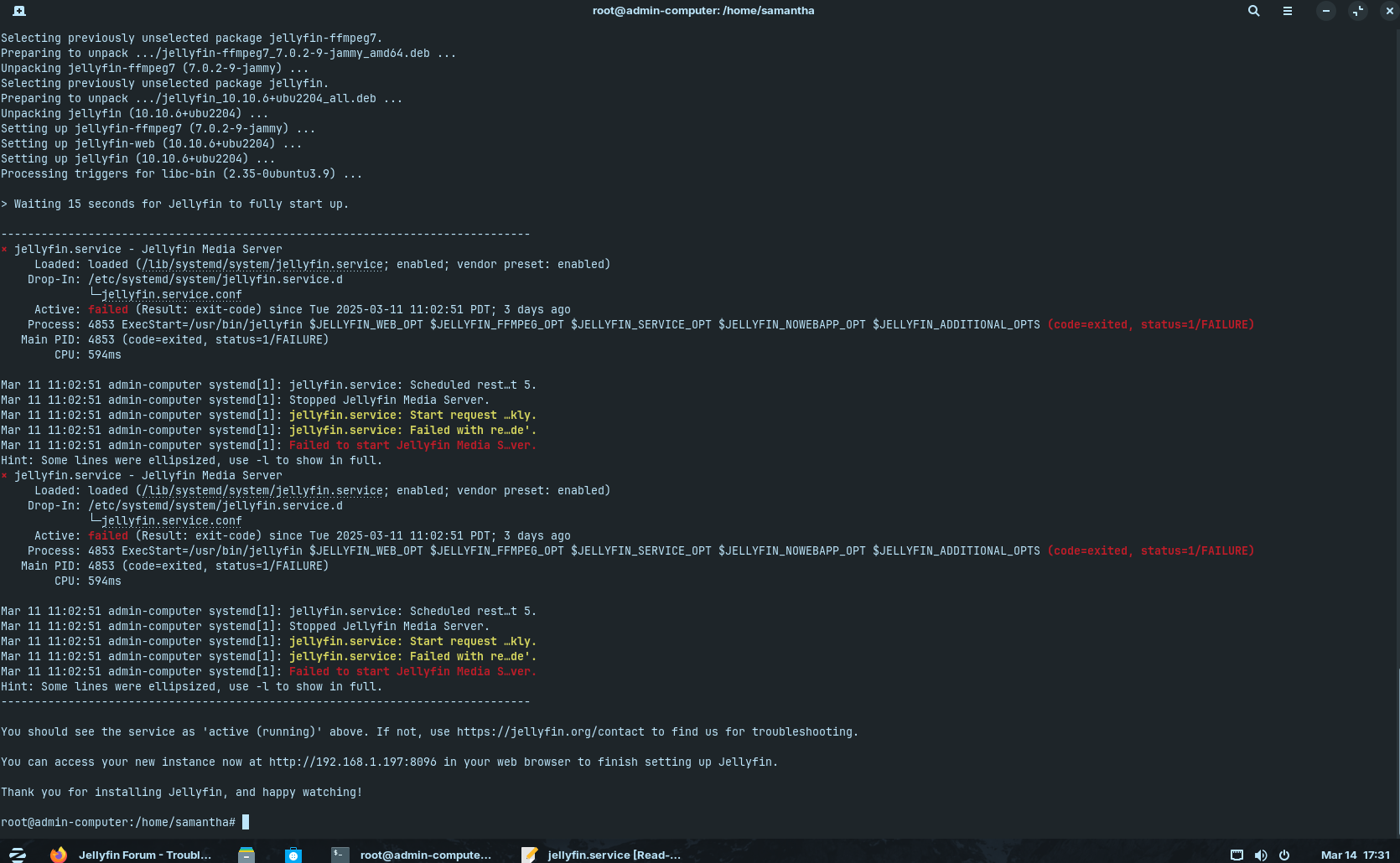

    sorry for the slow reply i had to go make dinner but this is the out put.
    Arguments: ["/usr/lib/jellyfin/bin/jellyfin.dll", "--webdir=/usr/share/jellyfin/web", "--ffmpeg=/usr/lib/jellyfin-ffmpeg/ffmpeg"]
    Mar 11 11:02:48 admin-computer jellyfin[4792]: [11:02:48] [INF] Operating system: Zorin OS 17.2
    Mar 11 11:02:48 admin-computer jellyfin[4792]: [11:02:48] [INF] Architecture: X64
    Mar 11 11:02:48 admin-computer jellyfin[4792]: [11:02:48] [INF] 64-Bit Process: True
    Mar 11 11:02:48 admin-computer jellyfin[4792]: [11:02:48] [INF] User Interactive: True
    Mar 11 11:02:48 admin-computer jellyfin[4792]: [11:02:48] [INF] Processor count: 4
    Mar 11 11:02:48 admin-computer jellyfin[4792]: [11:02:48] [INF] Program data path: /var/lib/jellyfin
    Mar 11 11:02:48 admin-computer jellyfin[4792]: [11:02:48] [INF] Log directory path: /var/log/jellyfin
    Mar 11 11:02:48 admin-computer jellyfin[4792]: [11:02:48] [INF] Config directory path: /etc/jellyfin
    Mar 11 11:02:48 admin-computer jellyfin[4792]: [11:02:48] [INF] Cache path: /var/cache/jellyfin
    Mar 11 11:02:48 admin-computer jellyfin[4792]: [11:02:48] [INF] Temp directory path: /tmp/jellyfin
    Mar 11 11:02:48 admin-computer jellyfin[4792]: [11:02:48] [INF] Web resources path: /usr/share/jellyfin/web
    Mar 11 11:02:48 admin-computer jellyfin[4792]: [11:02:48] [INF] Application directory: /usr/lib/jellyfin/bin/
    Mar 11 11:02:48 admin-computer jellyfin[4792]: [11:02:48] [ERR] The server is expected to host the web client, but the provided content directory is either invalid or empty: /usr/share/jellyfin/web. If you do not want to host the web client with the server, you may set the '--nowebclient' command line flag, or set'hostwebclient=false' in your config settings

    It seems like you attempted to install it using the install script, but the process failed. Based on the logs, there appears to be an issue with the web package. Let's try installing it manually. Download: https://repo.jellyfin.org/files/server/u...04_all.deb
    Once you've downloaded the file, open a terminal, navigate to the directory where the file is located, and execute the following commands:
    sudo systemctl stop jellyfin
    sudo dpkg -i jellyfin-web*.deb
    sudo systemctl start jellyfin
    After that, you should be able to access it in your browser using the address provided in your screenshot. If you still encounter issues, please share the updated results from the sudo journalctl command.

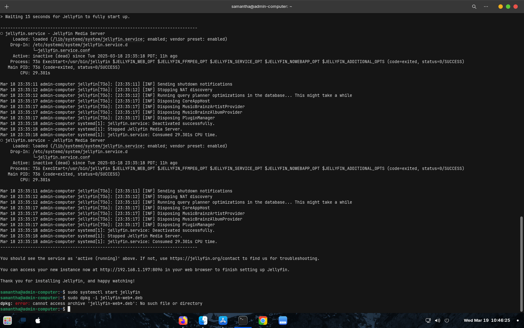

    2025-03-19, 06:37 AM
    here's what it did
    Reputation: 463
    2025-03-19, 12:34 PM
    I don't see anything in your post. Not sure why I didn't think of this sooner. Since Zoris OS is based on Ubuntu, you can use our auto-install script to ensure that you installed all the necessary packages.

    Samantha Adamovic
    Posts: 23
    Joined: 2025 Mar
    2025-03-19, 06:40 PM (This post was last modified: 2025-03-19, 06:43 PM by Samantha Adamovic.)
    Installing Jellyfin.
    Reading package lists... Done
    Building dependency tree... Done
    Reading state information... Done
    The following additional packages will be installed:
    jellyfin-web
    The following NEW packages will be installed:
    jellyfin jellyfin-web
    0 upgraded, 2 newly installed, 0 to remove and 1 not upgraded.
    Need to get 32.9 MB of archives.
    After this operation, 58.0 MB of additional disk space will be used.
    Get:1 https://repo.jellyfin.org/ubuntu jammy/main amd64 jellyfin-web all 10.10.6+ubu2204 [32.9 MB]
    Get:2 https://repo.jellyfin.org/ubuntu jammy/main amd64 jellyfin all 10.10.6+ubu2204 [2,296 B]
    Fetched 32.9 MB in 1min 34s (350 kB/s)
    Selecting previously unselected package jellyfin-web.
    (Reading database ... 296721 files and directories currently installed.)
    Preparing to unpack .../jellyfin-web_10.10.6+ubu2204_all.deb ...
    Unpacking jellyfin-web (10.10.6+ubu2204) ...
    Selecting previously unselected package jellyfin.
    Preparing to unpack .../jellyfin_10.10.6+ubu2204_all.deb ...
    Unpacking jellyfin (10.10.6+ubu2204) ...
    Setting up jellyfin-web (10.10.6+ubu2204) ...
    Setting up jellyfin (10.10.6+ubu2204) ...
    > Waiting 15 seconds for Jellyfin to fully start up.
    ○ jellyfin.service - Jellyfin Media Server
    Loaded: loaded (/lib/systemd/system/jellyfin.service; enabled; vendor preset: enabled)
    Drop-In: /etc/systemd/system/jellyfin.service.d
    └─jellyfin.service.conf
    Active: inactive (dead) since Tue 2025-03-18 23:35:18 PDT; 11h ago
    Process: 736 ExecStart=/usr/bin/jellyfin $JELLYFIN_WEB_OPT $JELLYFIN_FFMPEG_OPT $JELLYFIN_SERVICE_OPT $JELLYFIN_NOWEBAPP_OPT $JELLYFIN_ADDITIONAL_OPTS (code=exited, status=0/SUCCESS)
    Main PID: 736 (code=exited, status=0/SUCCESS)
    CPU: 29.301s
    but when i do jellyfin permissions in term it still says
    Quote:dpkg: error: cannot access archive 'jellyfin-web*.deb': No such file or directory
    even after reinstalling it how you said
