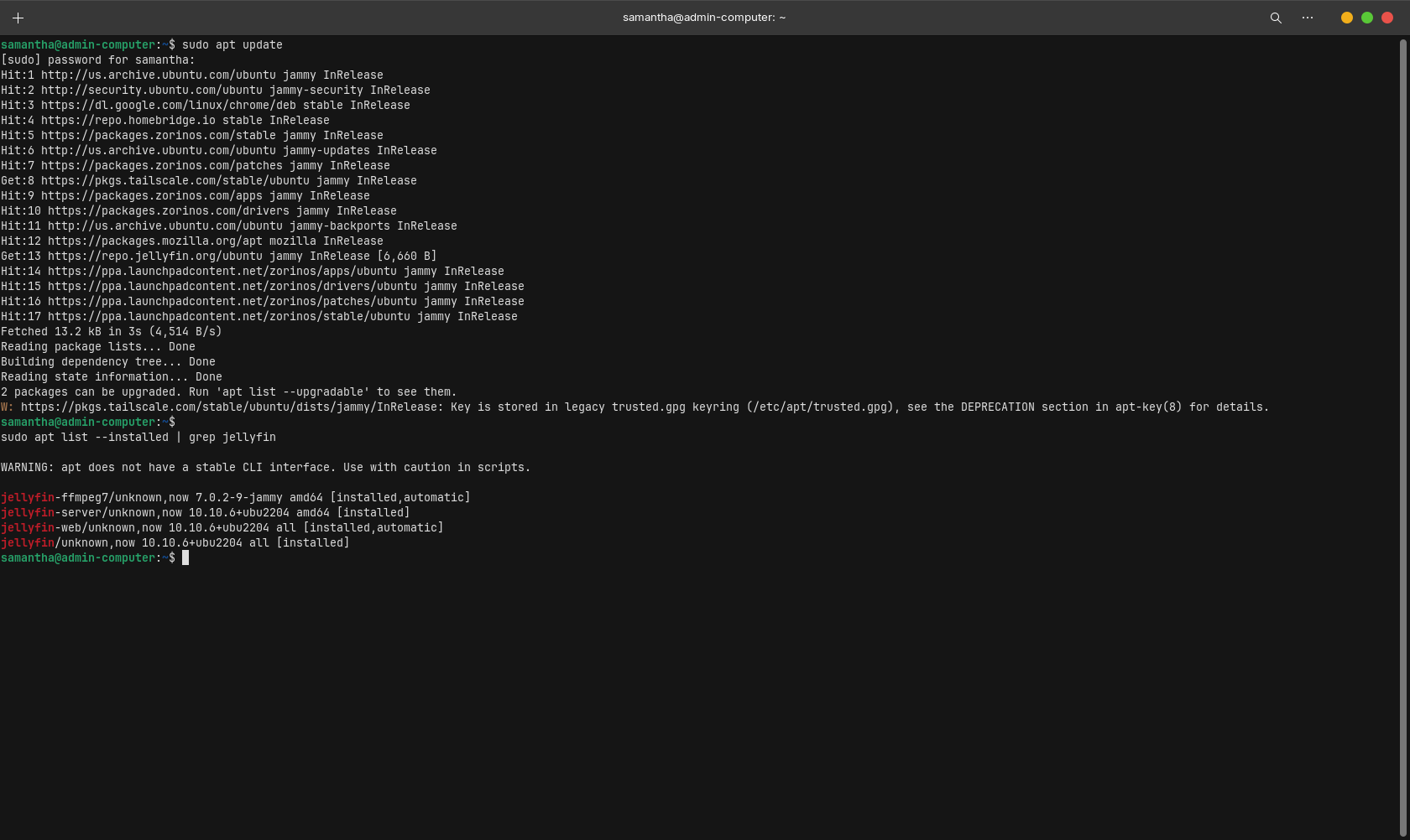

    #11
    2025-03-19, 06:56 PM
    This is not what I asked for. Run EXACTLY these commands.
    sudo apt update
    sudo apt list --installed | grep jellyfin

    #13
    2025-03-19, 11:25 PM
    here the out put. i also tried the stop, web, start thing the first two work.  the start command didnt (forgot to screen shot)
