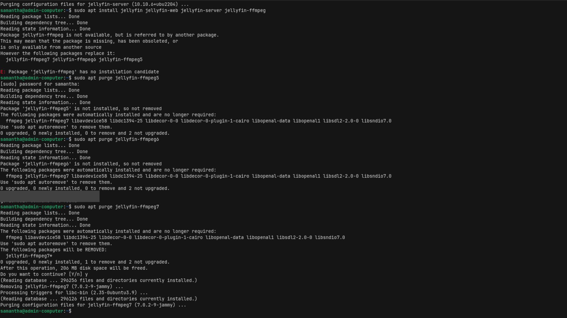

    2025-03-20, 03:46 PM
    here out put do i need do something else or just sudo apt install jellyfin jellyfin-web jellyfin-server jellyfin-ffmpeg
    Reputation: 461
    #18
    2025-03-20, 03:53 PM
    Ah. You have multiple old jellyfin-ffmpeg versions. I got the impression that this was your first time installing Jellyfin. Is that not the case?
    sudo apt purge jellyfin-ffmpeg5
    sudo apt purge jellyfin-ffmpeg6
    sudo apt purge jellyfin-ffmpeg7

    #19
    2025-03-20, 04:12 PM
    no it is ive just been told to delete it before. the greyed out part is my password i type it on accident
    Reputation: 461
    #20
    2025-03-20, 04:19 PM
    Much better. NOW try installing Jellyfin.
