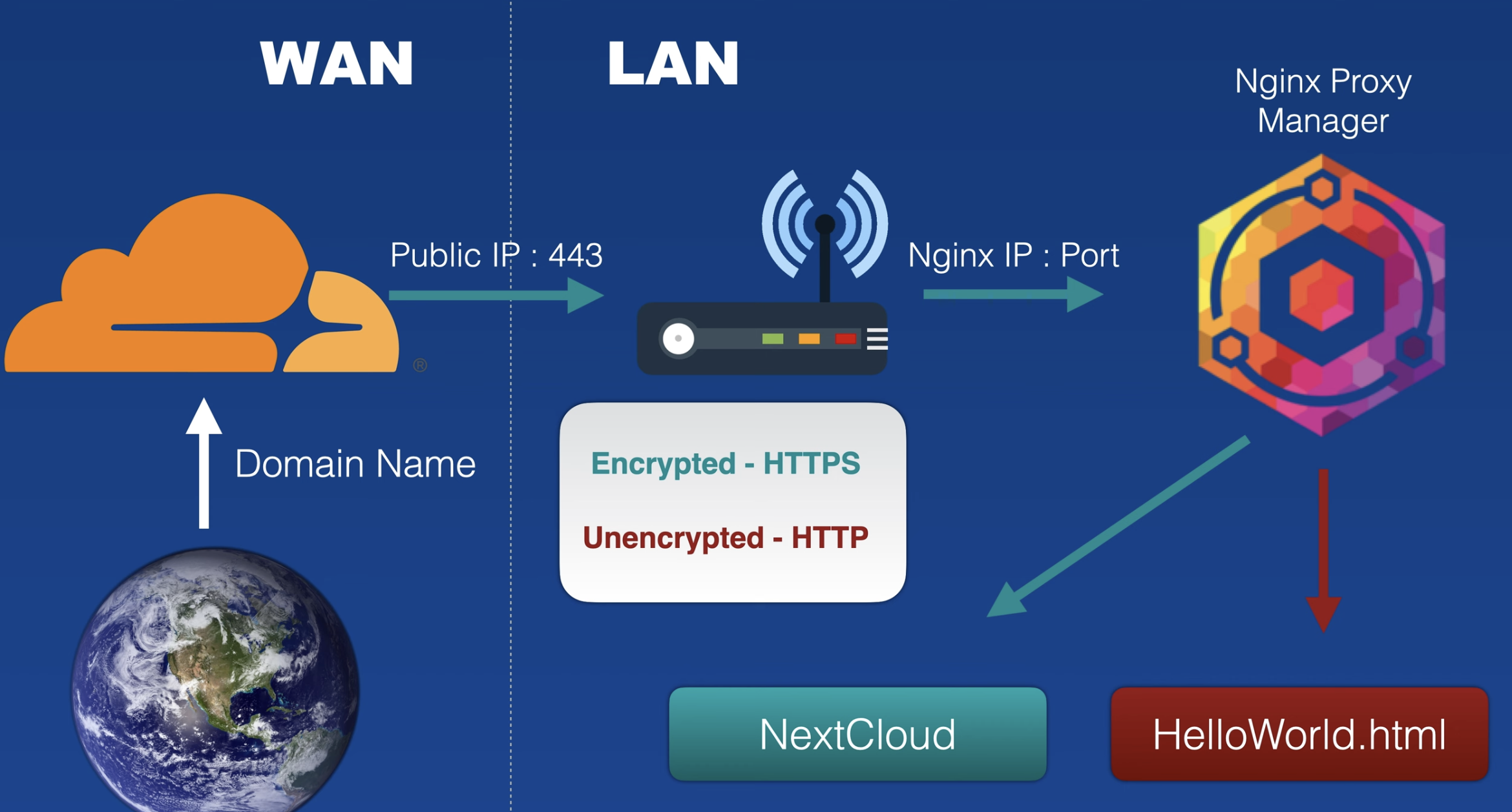

    I saw many tutorials talking about going through Cloudflare (in between the client and my router - See attachment).
    Any advice on that ?
    Reputation: 461
    #17
    2025-01-21, 02:49 PM
    Do not use Cloudflare with Jellyfin. It is against their TOS to serve video/audio through the free tier proxy service.
