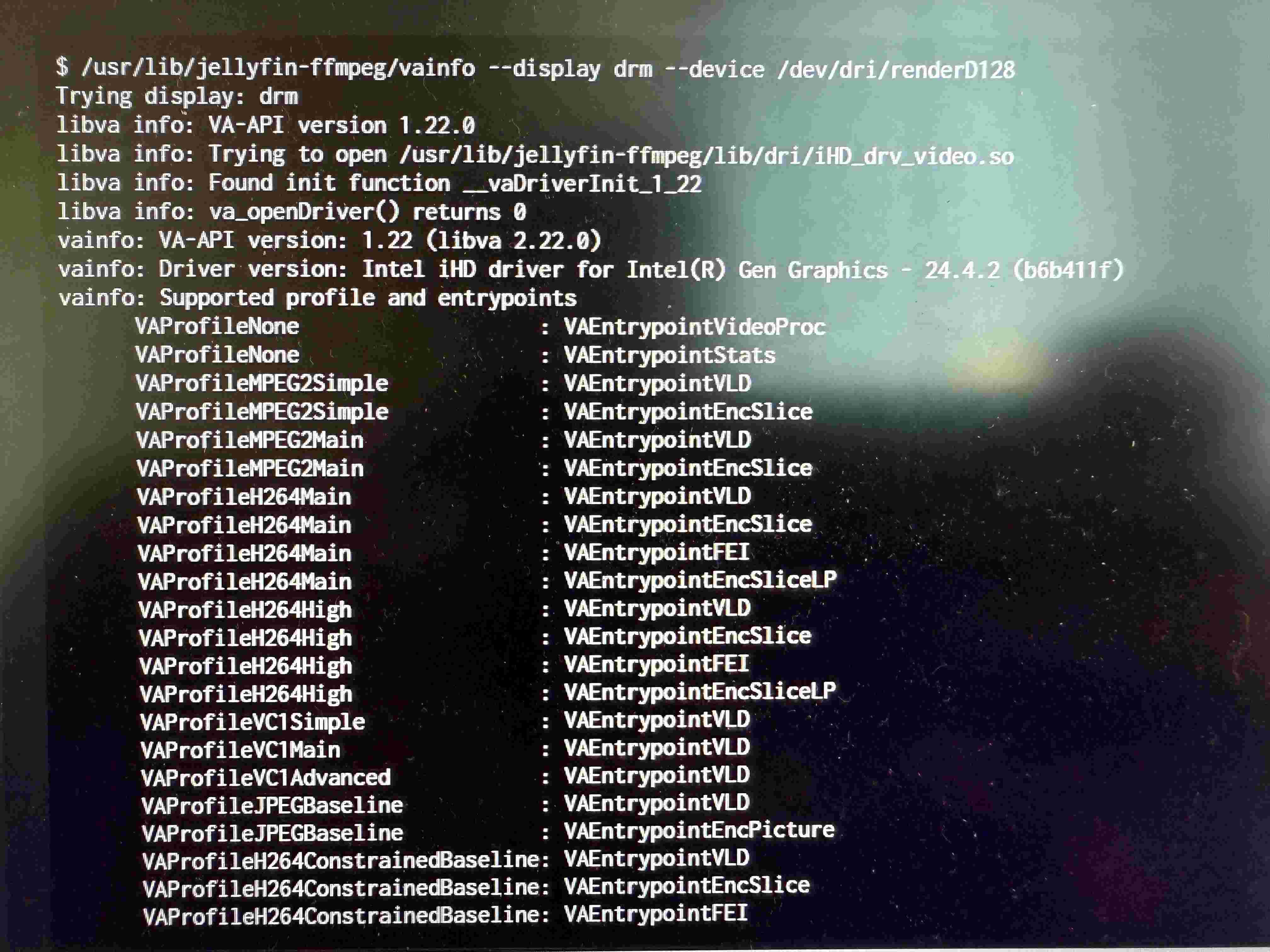

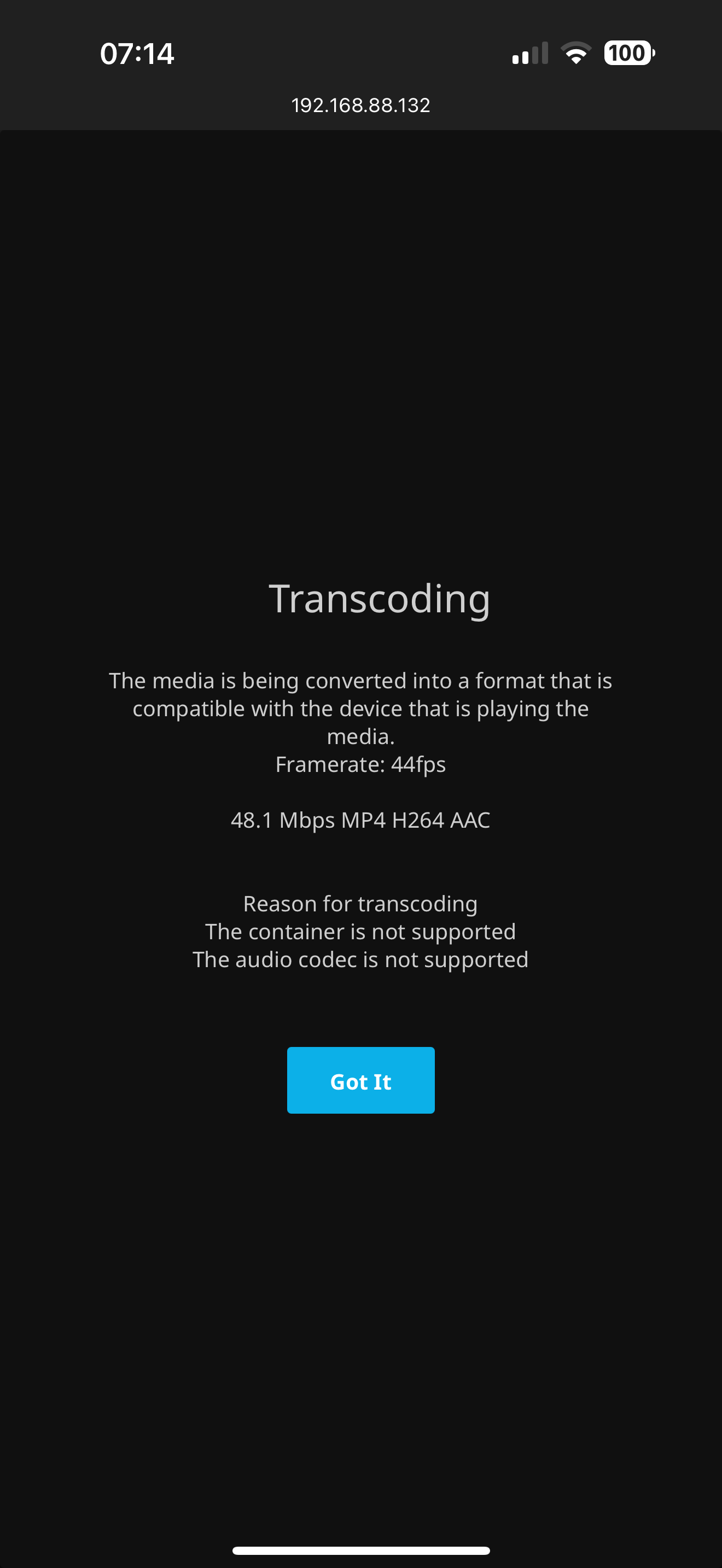

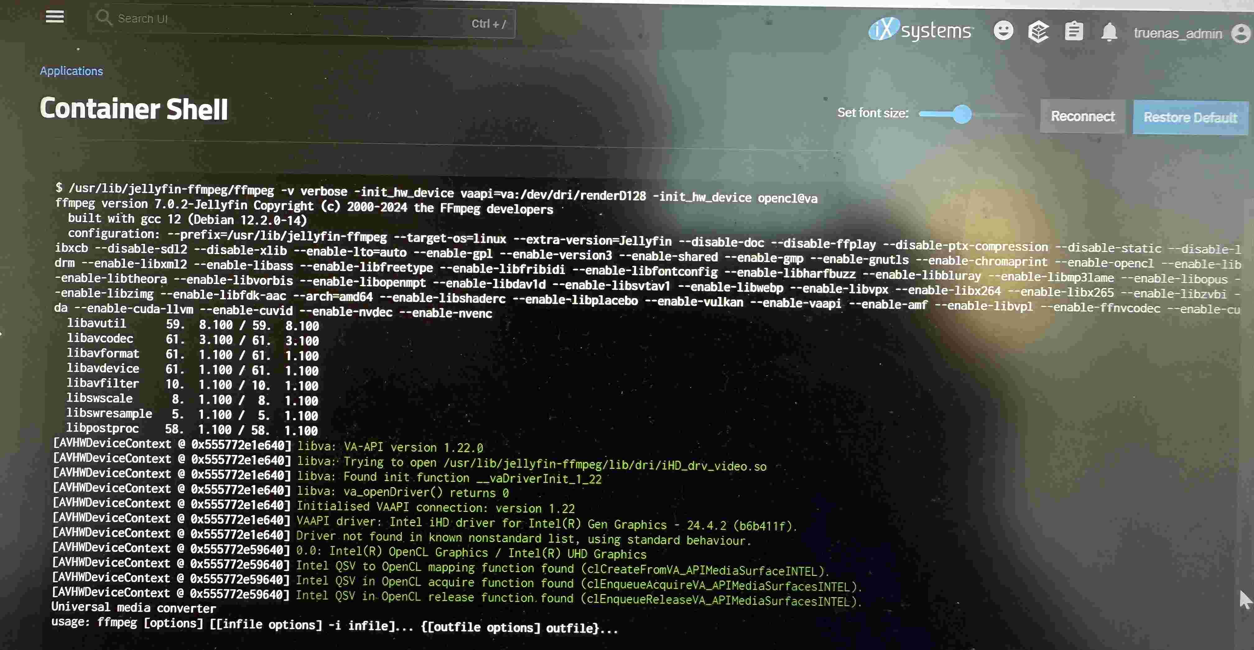

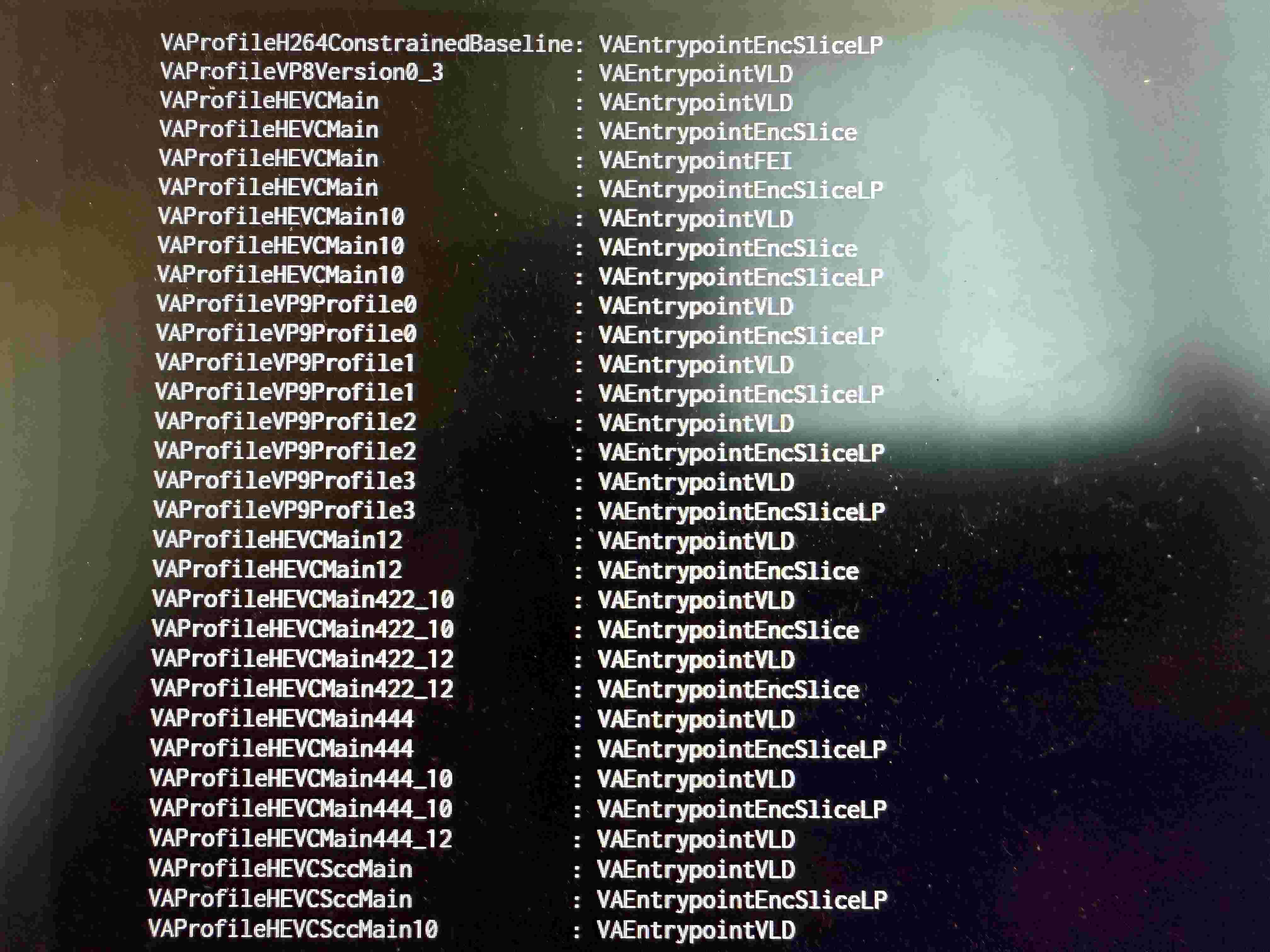

    I have a TrueNAS SCALE server based on an Intel N100 mainboard and I have installed Jellyfin in Docker with gpu pass-through to the container, I have checked and everything is working, see screenshots attached. Ithen tried to play a movie rip on Android Phone: Motorola G62 and it's stuttering like hell, I have also attached the log file which is showing me the following info:

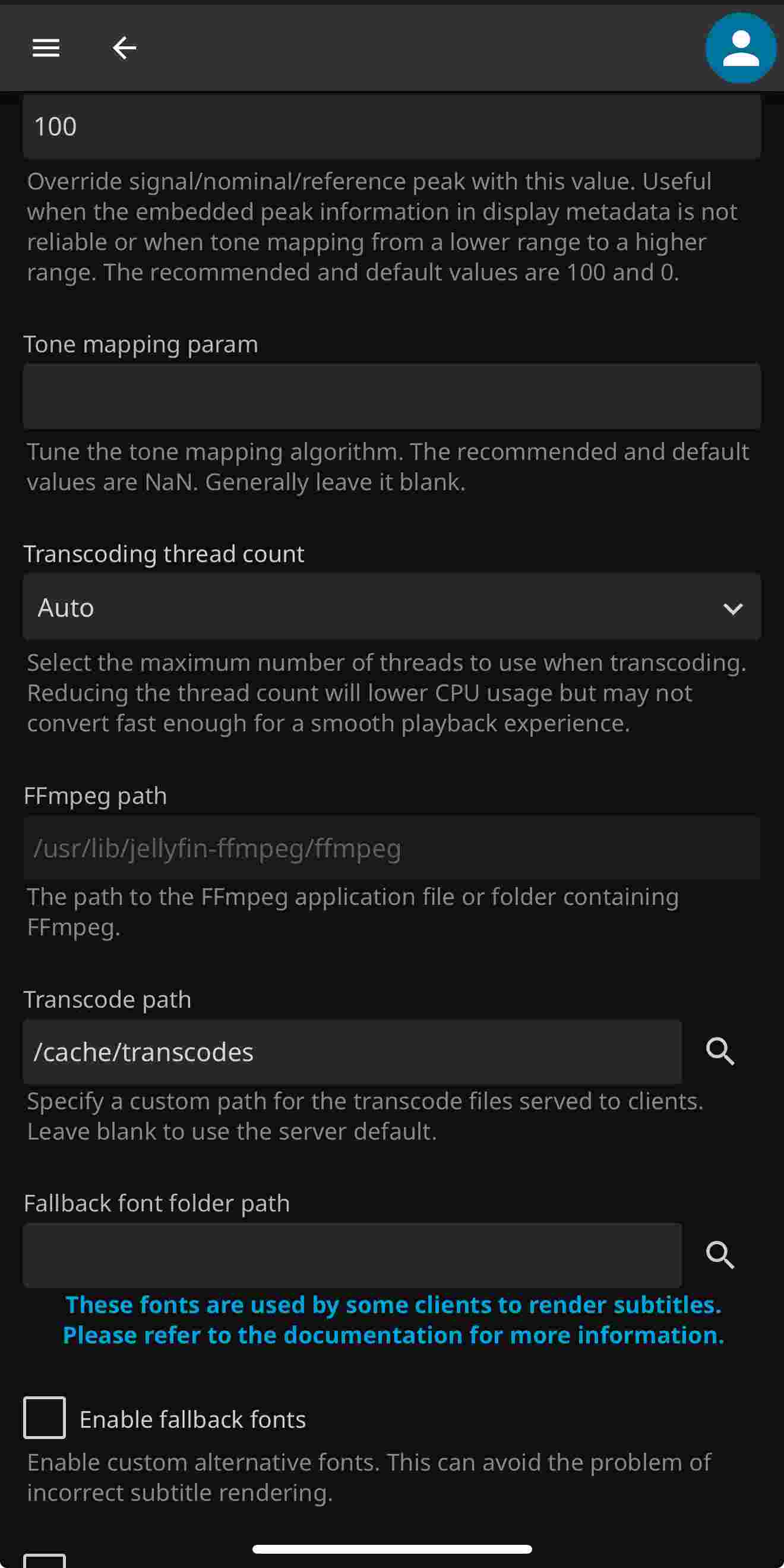

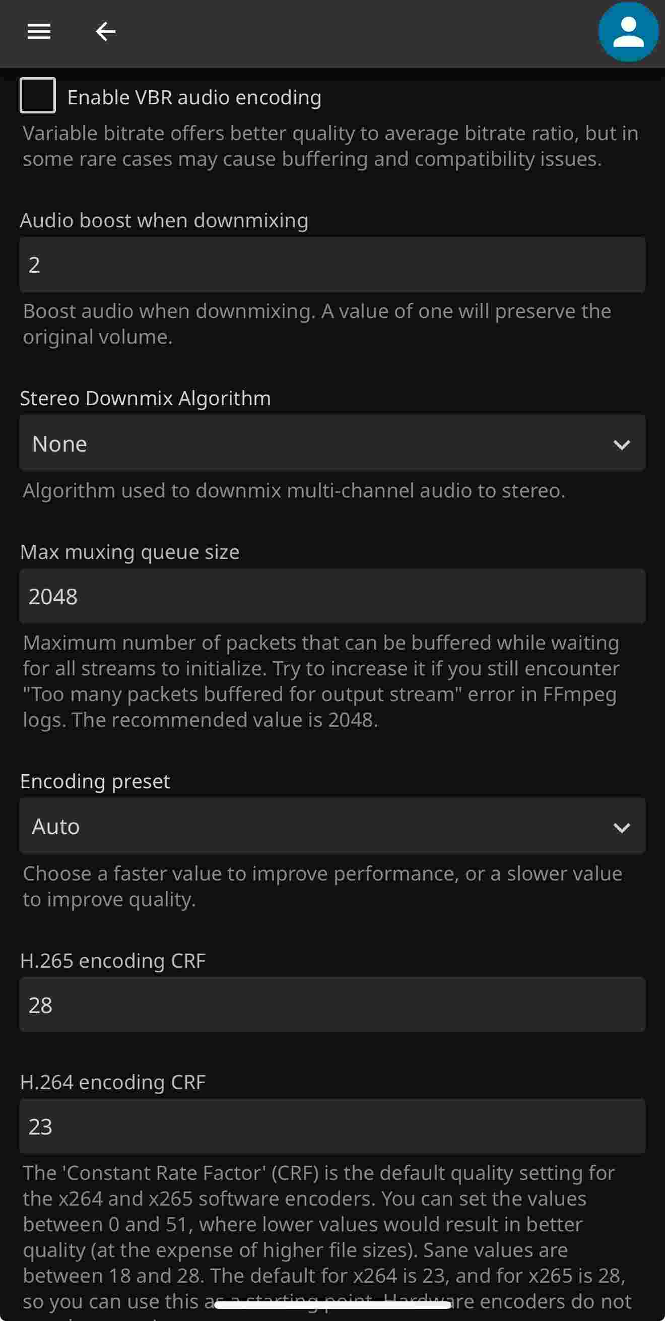

    I will reply with the screenshots of the transcoding section of the server in a second post.
    So what am I doing wrong? I really do not get it, is it because the qsv is not used for decoding? I saw in stream mapping:  (hevc (native) -> h264 (h264_qsv)) but I do not understand what it means, I see qsv for encoding but not for decoding.
    The same movie, this time on PLEX Pass, plays perfectly well with hw transcoding for both decode and encode.
    Thansk in advance for any hints that could help me solve the issue!
    And the settings of my transcoding section on the server side.

    Web player, with integrated player I cannot even start the video, see the error in the screenshot attached.
