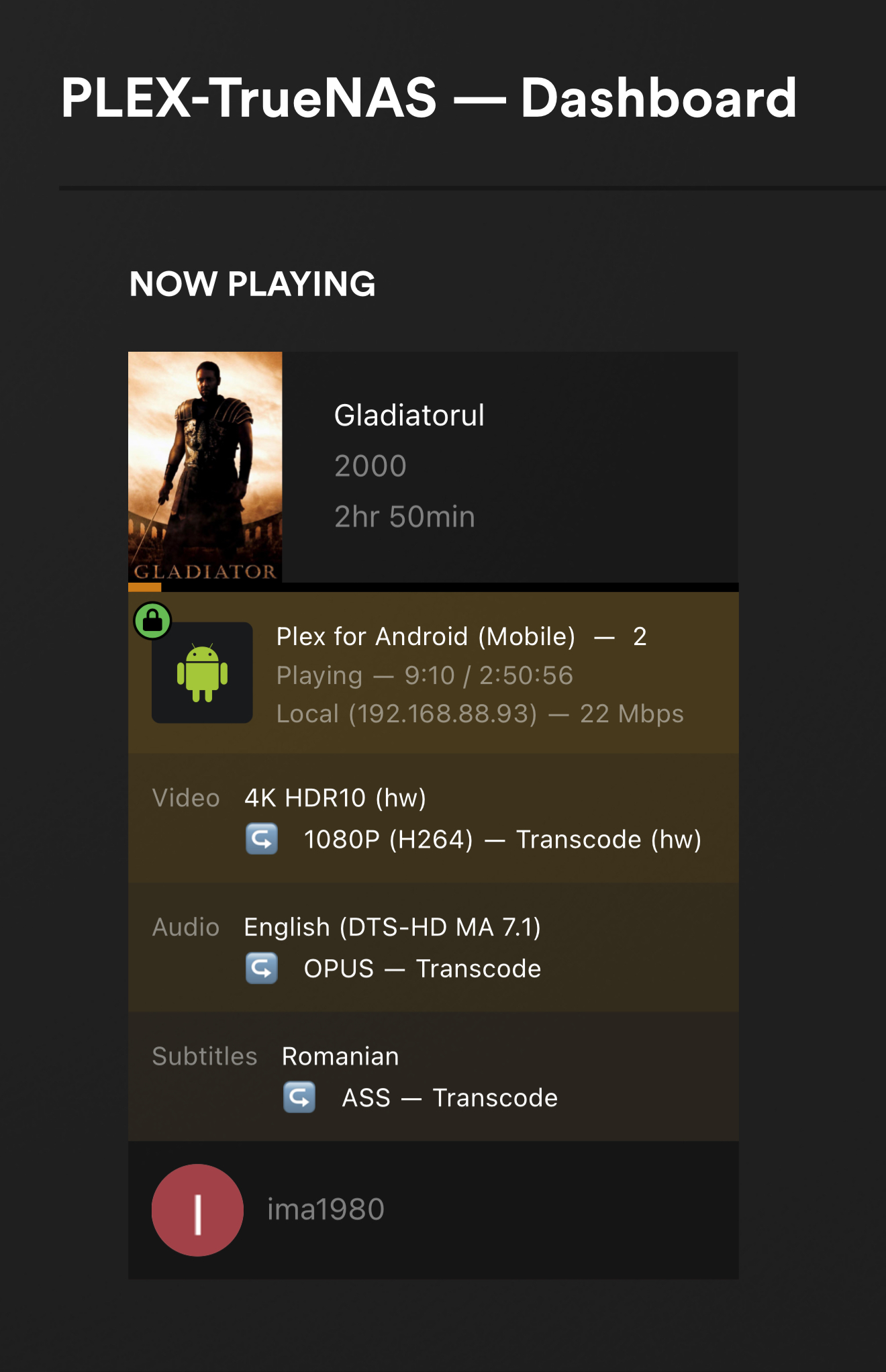

    ionutm80
    Joined: 2024 Dec
    Country:Romania
    2024-12-20, 05:58 PM
    (2024-12-20, 05:01 PM)TheDreadPirate Wrote: Do you know if Plex is transcoding down to 1080P?  There is a setting in the Android app to cap the resolution for transcodes (set it to 1080P).
    Yes PLEX is transcoding to 1080p and is a very smooth playback, no stutering at all, see screenshot from Plex server.
