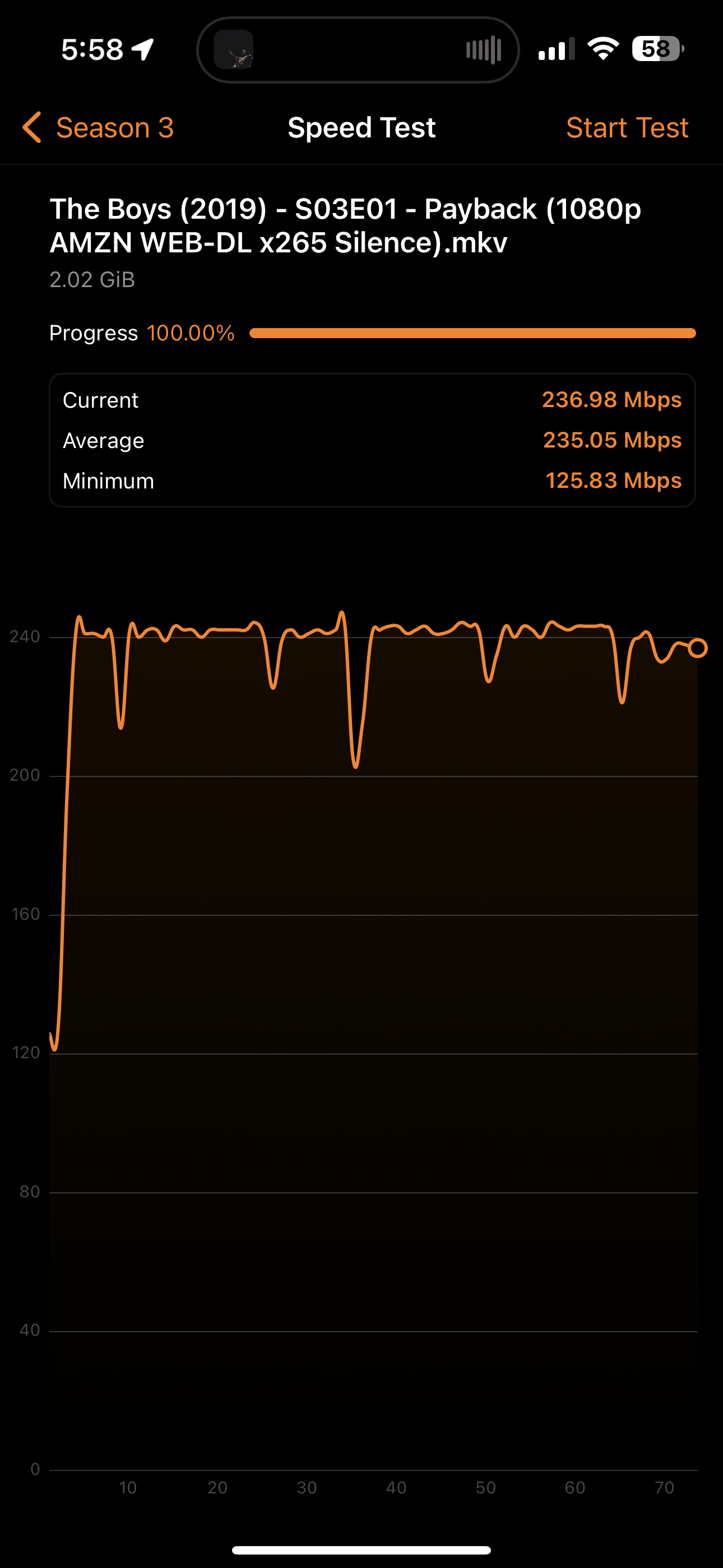

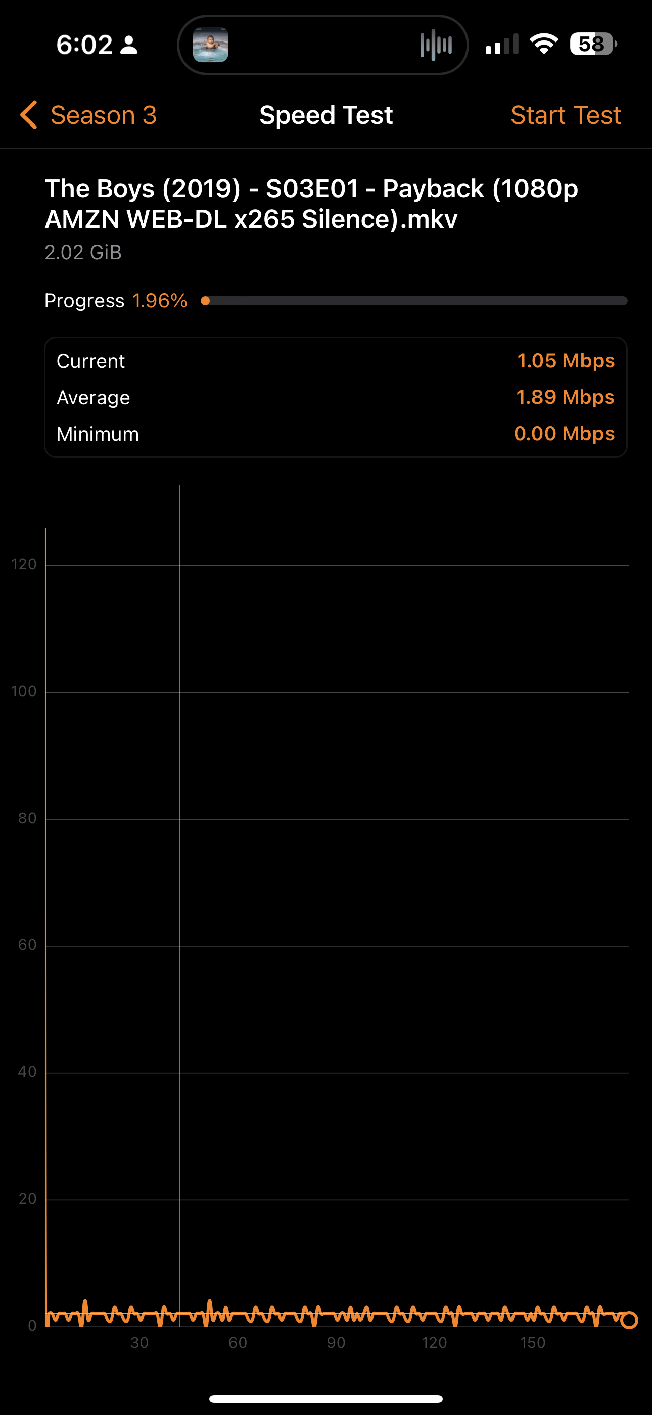

    While attempting to stream shows/movies from my Jellyfin server to my local devices I have very random drops in speed from 250+mbps to less than 2mbps for no apparent reason and does not speed back up to 250+mbps until I close/reopen/restart/etc. I am using the latest updated version of Infuse Pro on my up-to-date iPhone (iPhone 14 Pro) and Apple TV (ethernet - model A2843 running tvOS 16.6 build 20M73) to test the speeds via the "share" speed-test function. Shows/movies will stutter hard and fail to play or load in small chunks, play for a few minutes/seconds and then buffer again for long periods of time or if I'm lucky the entire show/movie will load in one go and I'll have no issues until I attempt to fast-forward/rewind or stop the show/movie and attempt to resume it.
    For the tests I would select a show/movie and press "start test" - it would begin the test reporting speeds of 250mbps+ the entire test no problem. If I stop and/or start a new test again it would either be full speed at 250mbps+ or completely throttle down to <2mbps until I stop and restart the test again (several times depending on how it decides to behave). I have included screenshots of the tests with my phone, I can include more from my TV if needed.

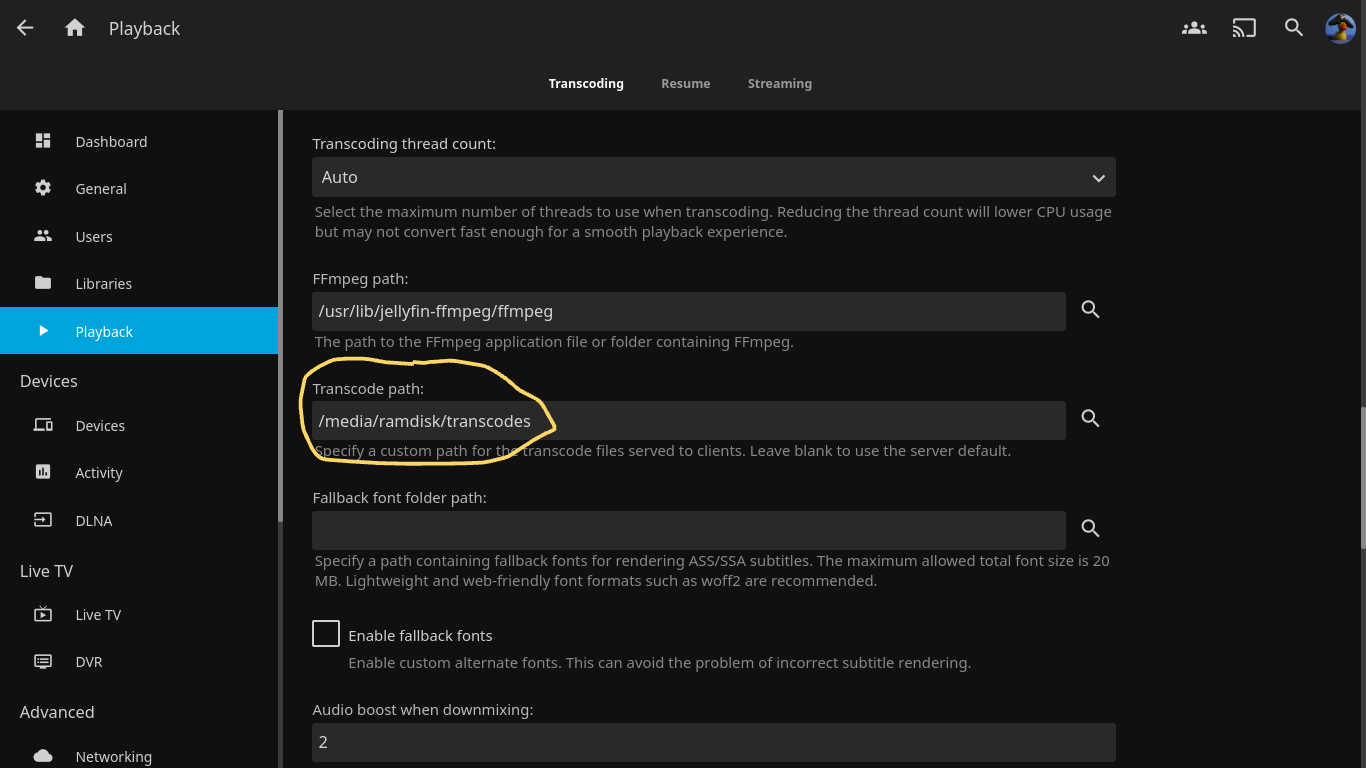

    Where are you writing the transcodes to? Are any volumes filling up when it is transcoding?

    I am not sure where to check for where I'm writing transcodes to. I do not see any of my drive volumes filling with unexpected or large amounts of data either.

    Your transcoding directory is in Settings > Dashboard > Playback   (About halfway down)
    Since the ffmpeg log you attached was copying the video and audio into a new container (no reencoding) if the transcode directory is on a small volume it would fill up pretty quickly.  I'm saying that is what is happening.  Just grasping at straws.

    I went looking for the transcode folder and found 658 items in it totaling up to 1.1GB of disk usage. I wasn't sure if there were corrupt or partial files in it so I deleted all of them and restarted the server to "refresh" everything. I did re-enable transcoding as per your advice.
    The drive the transcodes are sitting on is an 870 Evo with 250+GB of space remaining.
