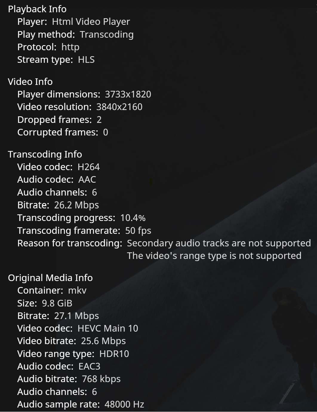

    I used the command "usermod -aG [group1],[group2] [user]" to get what I think is the correct user into the "video" group, user is listed in the video group, but no improvement. Transcoding a 4K video to a windows browser causes the CPU to go to approx 50%. I think that is wrong. The steam info is attached.
    How do I confirm the user for Jellyfin when it is running as a Portainer container; as I suspect that I may be referencing the wrong user. I am using the PUID of the container to determine the user, that may be the wrong thing to do.
    2023-09-19, 05:02 PM
    50% CPU usage on a N5095 during transcoding sounds about right. Even if you are using the iGPU to do the actual encoding, the CPU still has to compose and feed the iGPU. I can tell you right now that 4K, 50FPS is NOT happening with a CPU transcode on a N5095. Heck, a 1080P transcode is not happening on a N5095. That is definitely an iGPU transcode.

    Thanks for the advice to confirm, I still had doubts, but it does seem to be working. Below is a 4k video streamed to a Win 11 machine in an Edge video player.

    2023-09-20, 07:27 PM
    (2023-09-20, 07:19 PM)fcs001fcs Wrote: Stream mapping:
      Stream #0:0 -> #0:0 (hevc (native) -> h264 (h264_qsv))
      Stream #0:2 -> #0:1 (eac3 (native) -> aac (libfdk_aac))
    Definitely hardware accelerated.  What I highlighted would say "libx264" if it was software transcoding.  But the audio is software transcoding so that contributes to your CPU usage.
