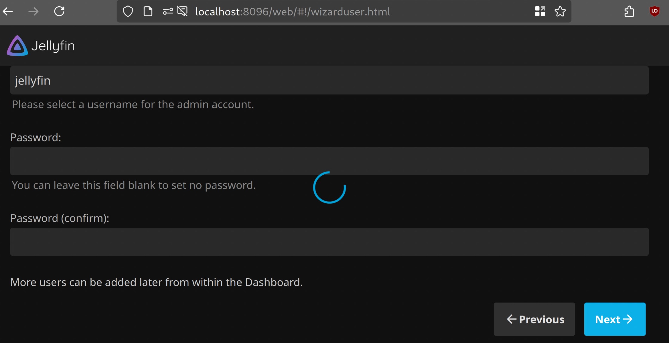

    So, starting from scratch it is, and after restoring the jellyfin.env (from backup) and restarting my machine, I get this far when I just click next (as I plan to just run it locally, allowing no incoming connections):
    I can wait forever and the spinning won't stop, and if I reload the page, the process starts over. Flatpak version did not have this issue.
    System ctl status (and log as well) has only this to say:
    jun 14 23:51:18 leplup jellyfin[3316]: [23:51:18] [INF] Core startup complete
    jun 14 23:51:18 leplup jellyfin[3316]: [23:51:18] [INF] Startup complete 0:00:03.1358426
    jun 14 23:51:20 leplup jellyfin[3316]: [23:51:20] [INF] Clean up collections and playlists Completed after 0 minute(s) and>
    jun 14 23:51:21 leplup jellyfin[3316]: [23:51:21] [INF] Update Plugins Completed after 0 minute(s) and 1 seconds
    jun 14 23:51:43 leplup jellyfin[3316]: [23:51:43] [INF] Saving system configuration
    jun 14 23:51:43 leplup jellyfin[3316]: [23:51:43] [INF] Setting cache path: /var/cache/jellyfin
    jun 14 23:51:43 leplup jellyfin[3316]: [23:51:43] [INF] Stopping NAT discovery
    jun 14 23:51:43 leplup jellyfin[3316]: [23:51:43] [WRN] No users, creating one with username jellyfin
    jun 14 23:56:07 leplup jellyfin[3316]: [23:56:07] [INF] Saving system configuration
    jun 14 23:56:07 leplup jellyfin[3316]: [23:56:07] [INF] Setting cache path: /var/cache/jellyfin
