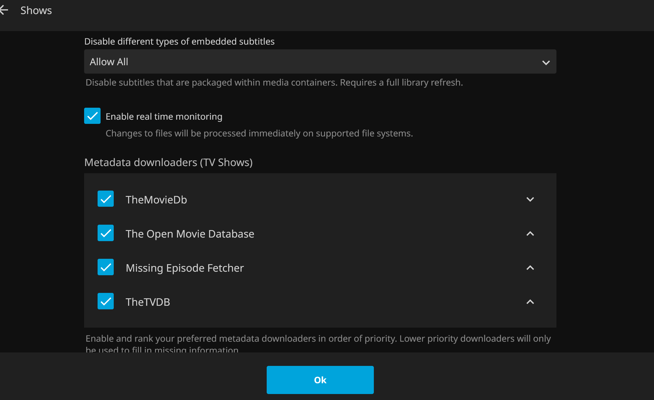

    If you have the TVDB plugin installed, then in your shows library there’s an option “Missing Episode Fetcher” that needs to be unselected. It’s usually a pain to get rid of these dummy episodes once selected and I believe it is still a bug. My advice would be to delete the library and then re-add your TV shows library making sure to unselect that option.

    The "Missing Episode Fetcher" is in the library settings: Dashboard -> Libraries then choose your library and select Manage library. Note this option is only there if you have the TVDB plugin installed.

    Thank you so much, I found the setting as recommended above! I’m sure it’s going to be a process to get the phantom episodes removed from clients but at least the root cause is resolved! Thanks again @theguymadmax
