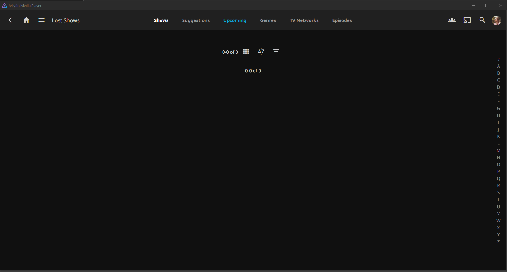

    The version of Jellyfin you are running 10.9.9
    Your installation method and platform:
    Platform: TRUENAS-MINI-3.0-X
    Version: TrueNAS-SCALE-23.10.2
    Source: TrueNAS Catalog

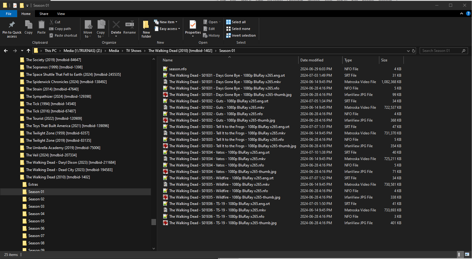

    Directory: The 100 (2014) [tmdbid-48866]
    Subdirectory: Season 01
    Subdirectory: Season 02
    Subdirectory: Season ...
    File: The 100 - S01E01 - Pilot - 1080p BluRay HEVC.mkv
    etc
    Jellyfin App on Windows 10 (not showing up in Infused on AppleTV either)
    0-0 of 0

    Ya this is my first post. I can't even add new attachments, or edit the original to add new ones. I've dragged and dropped, click to add, used Chrome, used Firefox. I'm a lil dysregulated from another thing with grocery delivery, so this is hitting a lil harder than normal.
    I do have a library that is just TV. in the numbers there is no The 100, under then Ts there is no The 100.
    Desktop I can see it there in the directory tree. I SMB share over my stuff to the server.
    3 Body Problem, 11.22.63, 12 Monkeys, 13 Reasons Why etc all show up. This show does not.

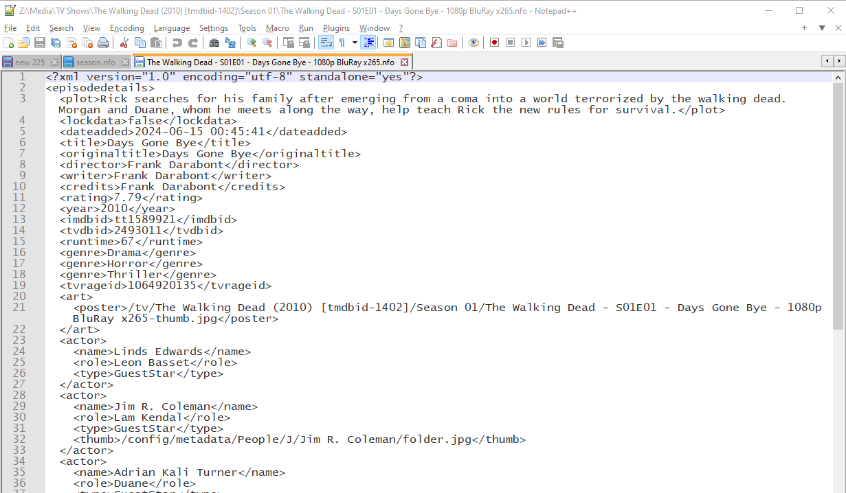

    Second, it looks like you have NFO files associated with your files. Jellyfin prioritizes NFO files for metadata, so if the NFO files are incorrect, Jellyfin will import the show with the wrong information.
    Try this: Move the folder out of the TV shows directory, then delete all the NFO files. After that, move the folder back into the TV shows directory and see if Jellyfin recognizes it correctly.

    Jellyfin has determined that it is yet again "The 100" is "The Walking Dead", and generally is having issues with that
