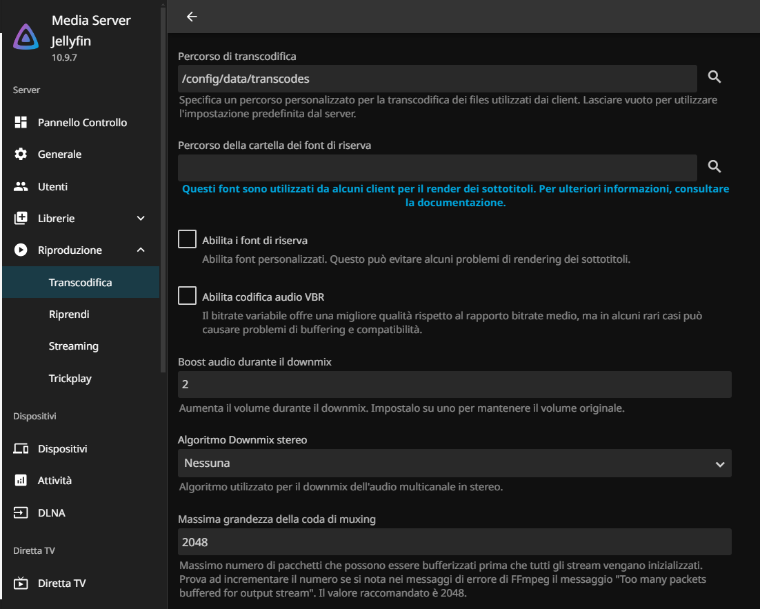

    where do I check that transcoding is disabled for subtitles? ... I don't think I disabled it!
    Thanks
