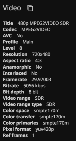

    Hi I'm having a similar issue with a Docker install of Jellyfin 10.10.7 on my DS224+
    https://privatebin.net/?89c0db91cd58c9e9...gWyqQ7ZH11
    In this file is my Docker compose file, as well as a recent Jellyfin log and FFmpeg log when I try to play a video.  The video content I am trying to play is

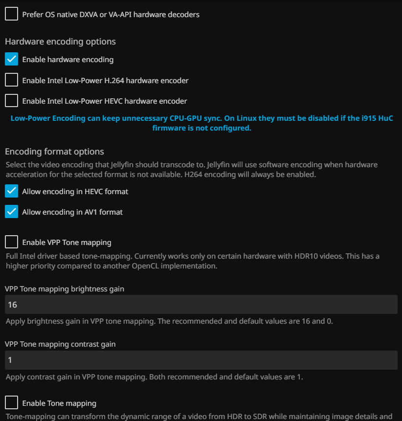

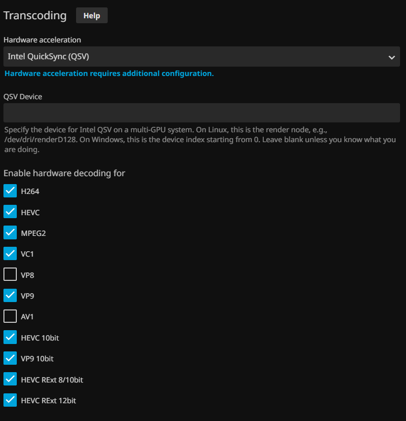

    and here are my transcoding settings in Jellyfin
    I have read in other threads on the forum with this device about disabling tone mapping or setting the device to /dev/driConfused-facedev/dri instead of declaring it explicitly.  However, these options do not seem to work either.  Any help is appreciated.

    You should disable AV1 encoding for a start. Your NAS CPU doesn't support it.
    https://kb.synology.com/en-uk/DSM/tutori...y_NAS_have
    https://en.wikipedia.org/wiki/Intel_Quick_Sync_Video

    Resolved!
    All I had to do was change the user declaration in my Docker Compose file to be 1026 (user) and 937 (video group). You can check to see what your video group is by running this command as root user:
    cat /etc/group | grep video

    (2025-08-11, 02:33 PM)sb19 Wrote: Resolved!
    I'd be careful with the user declaration. You might try group_add instead.
