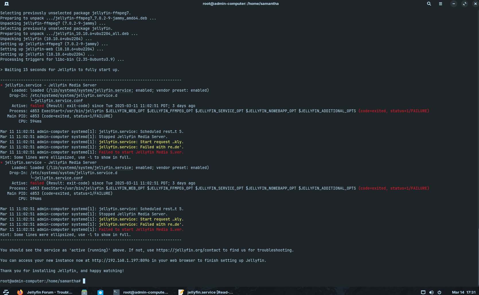

    Samantha Adamovic
    Posts: 23
    Joined: 2025 Mar
    2025-03-19, 06:24 AM
    I thought I fixed it evidently not
    Samantha Adamovic
    Posts: 23
    Joined: 2025 Mar
    2025-03-19, 06:41 AM
    heres what it did
